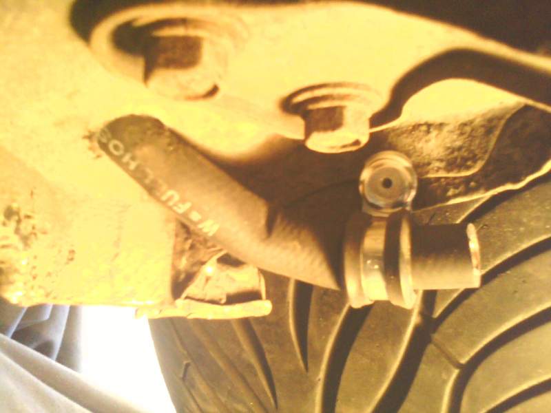

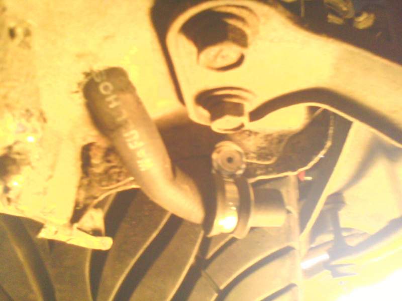

My sills have already gone, they've been rewelded up. It turns out that one of the 2 bodyshops in the past nightmare I had (not the guys my car is with now I'd like to point out) had actually filled in the drivers side rear drain valve. I'm doing what Andy did and running new pipes in one piece
I did mine slightly differntly. I used a single pipe from the top to the bottom and where it exits, I pushed a 10mm copper olive into the pipe, so it flairs the end and stops the pipe going back in the hole. I then used some Sikaflex to fix it in place an seal the hole. I'll post up some pictures when I take them :)
