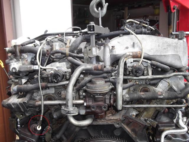

So nearly done, but there are a few things I forgot / didn't take a photo of as I was undoing it.

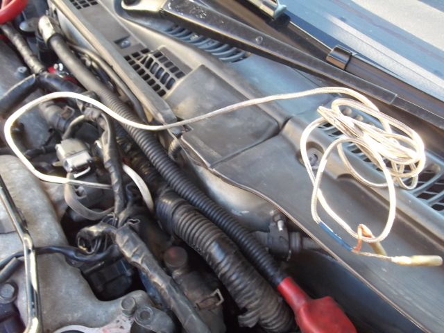

So first thing is this silver cable . . . does anyone know where it goes or what it does?
It wasn't connected to anything when I removed the engine and I forgot to investigate while engine was out.

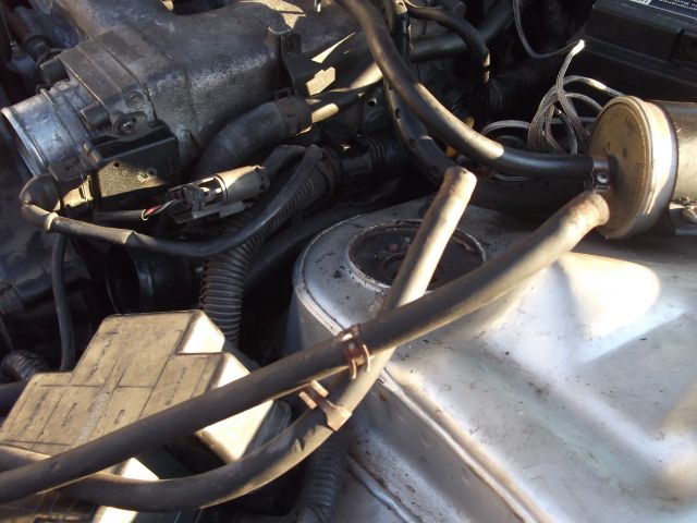

Second thing is these boost pipes, where do they go? I know one goes to a nozzel on the side of the plenum but the other . . . I have no idea.
Thanks in advance.
