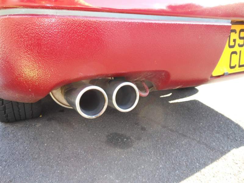

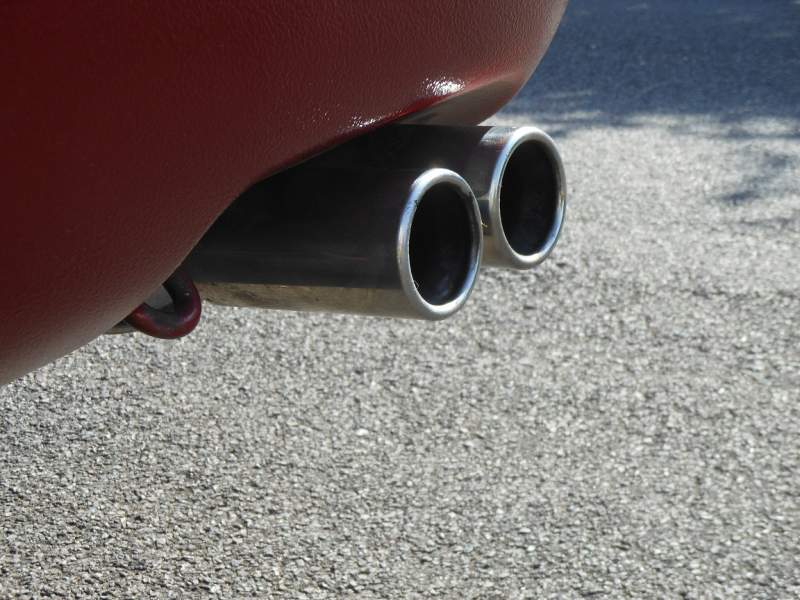

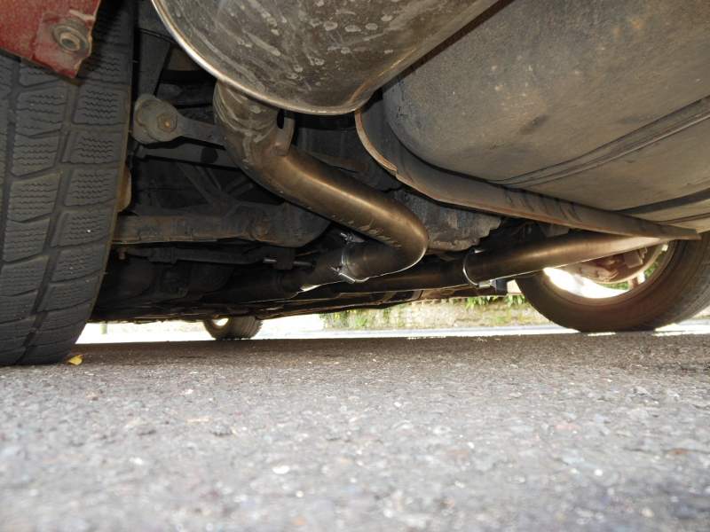

Done and it went great. no ceased bolts, salvaged original metal gaskets, and used RTV silicone, left it 20 mins, and been out for a drive.
The difference, is Amazing. its quiet, throttle response is now immediate. no delay in the downshifts, I can now say it would hammer the MK2 Focus RS. The difference is huge.
So Pleased.
Big thanks to Ian (300ZX_666) for supplying me with the Exhaust.
Big recommendations to the Mongoose System for everyone else.

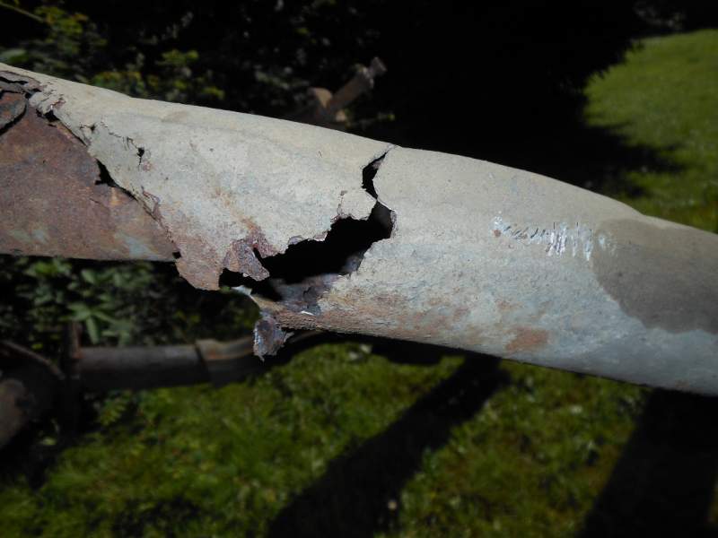

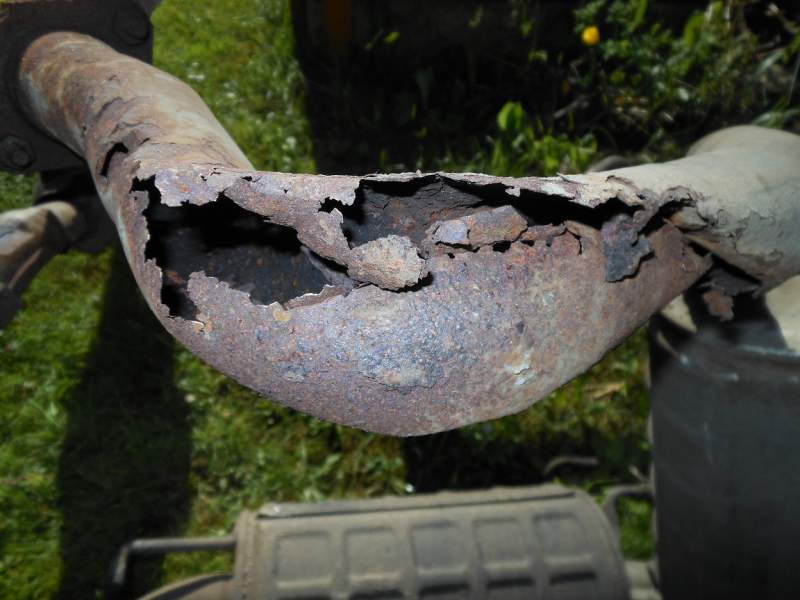

The Reason I needed to change it sooo bad:
blimey, that old exhaust was proper fa-hooked! :shock:
yep, never seen one that bad in my life, mind you it was the original OEM exhaust, its never been changed. I just wanted it of, incase the rust decided to spread anywhere else lol.
Nothing to do with the fact it was blowing its tats off then :lol:
What's the difference in sound like?
I have just bought the same system and can't wait to feel and hear the change.
Well excited.
Thank for the pic's also.
and that lmao
Well excited.
Sounded awful before due to blowing. its a nice rumble but not loud, but when you put your foot down, it has a typical V6 throaty roar :D
