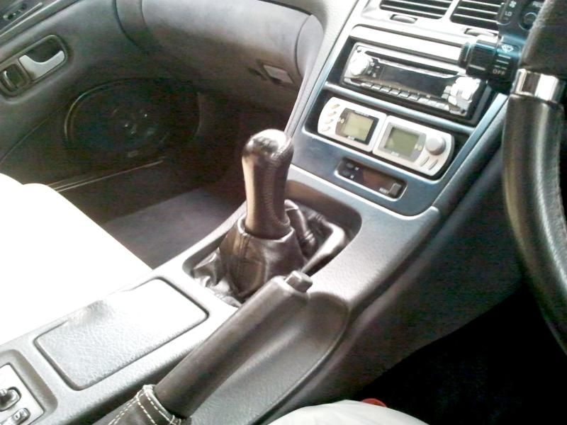

Ok so a different level for changing gear now??

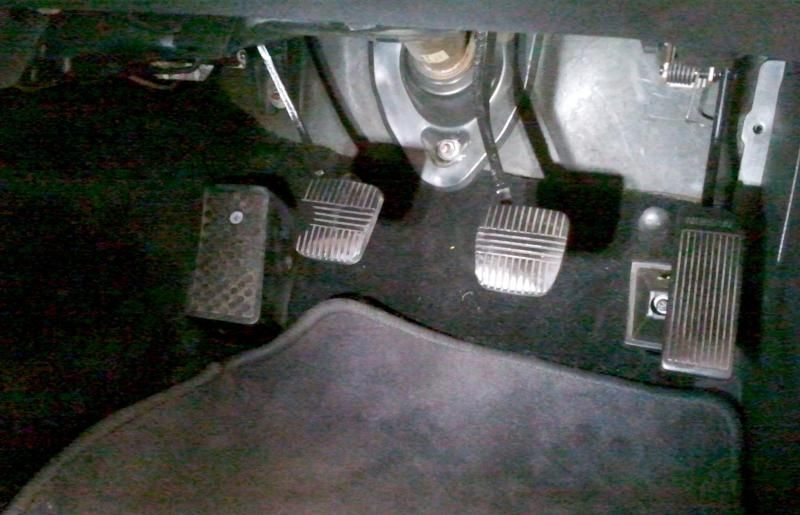

An extra pedal too...

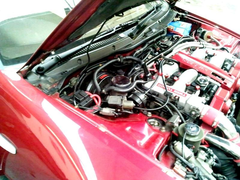

New pipework arrangement an extra master cylinder...
Reverse lights connection....

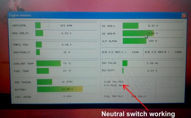

More electrical connections....Neutral switch...

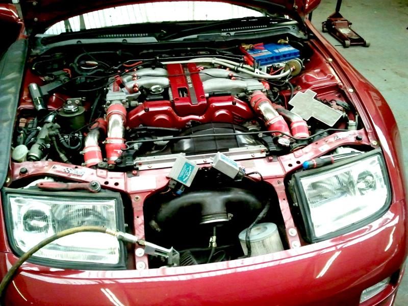

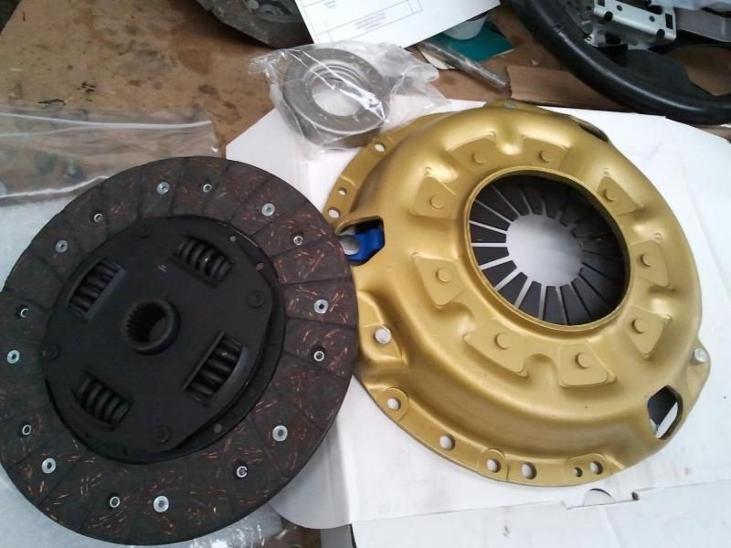

Organic full face clutch with high load cover...
Checking all ok...
Ticking over waiting to go
