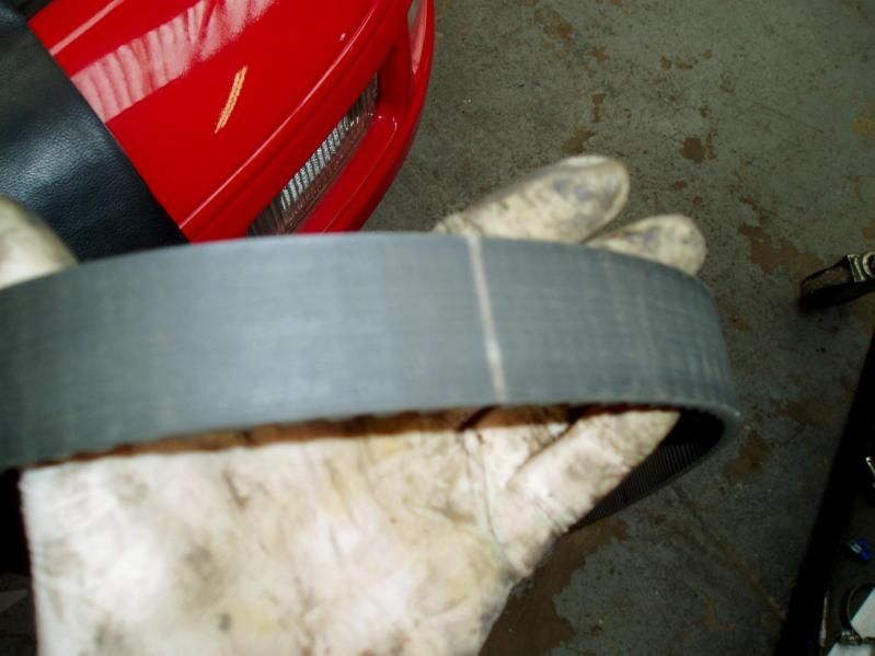

So a cambelt service is a normal run of the mill job yesterday but one that reminded me of how easy it is to get things wrong if you do not know how to check things correctly.
Have heard a few owners here and our own customers sometimes suggest the cambelt is ok because they checked it by looking behind the right hand cover, now whilst you can check its general condition its no where near acurate enough to make a long term decision on.
So back to the case in point, take a look at the first picture below of the belt I removed, it could be taken as a belt in good condition, even the timing lines are still there as is the Nissan logo further round.

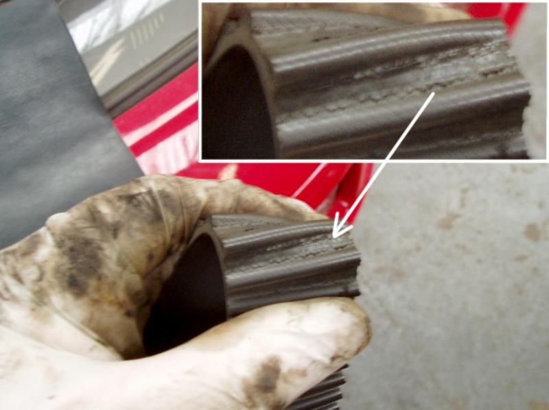

Picture two of the teeth even look fine and sharp edged with little sign of wear, however picture three reveals the true condition of the belt when bent over, the teeth seats are delaminating and in some area`s the teeth are lifting away from the main body of the belt......close call or what?
Given the mileage of this zed and this was not the original belt either then the its clear the belt condition is due to age rather than wear and tear with the rubber just deteriorating over time.....now your gonna want to check your eh ???

Id say that was a close call. Well spotted Jeff. Shows the extra detail you put into your work, most garages would of just chucked it to the side without checking overall condition as they have done what they were paid to.
