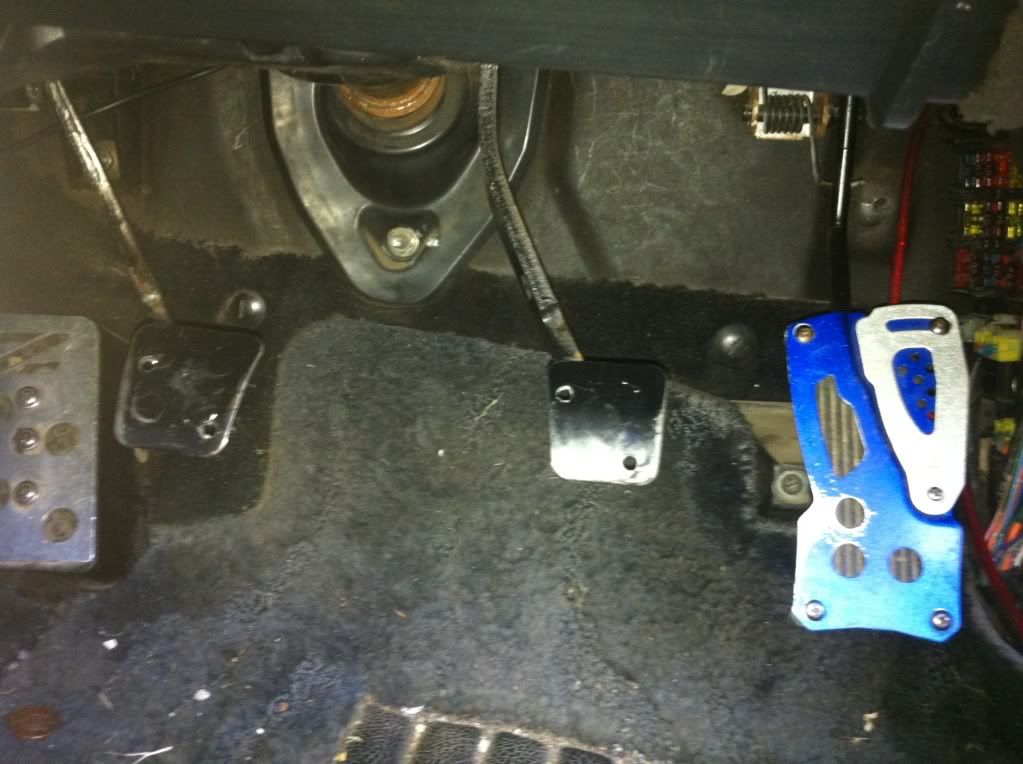

i aint even changed the gearbox yet bud. all i did today was stick the clutch pedal and brake pedal in lol. still need to change the throttle pedal yet.

Click image for video, pretty much a small video for those that struggle getting the clutch pedal assembly in place due to the thick wiring loom at the top, man i sound strange in that video lol

Didn't use glue bud, there is this new invention called bolts and nuts, i used the nuts on the threads that came on the parts supplied :lol:
