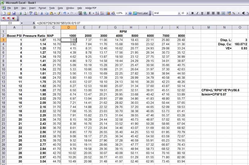

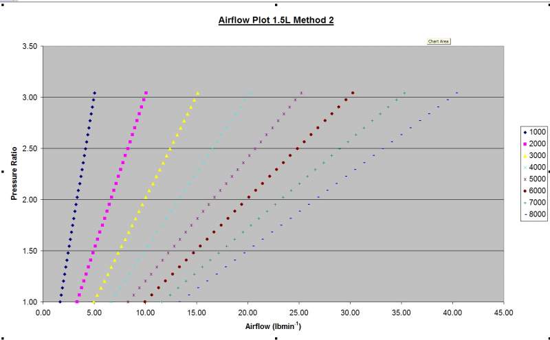

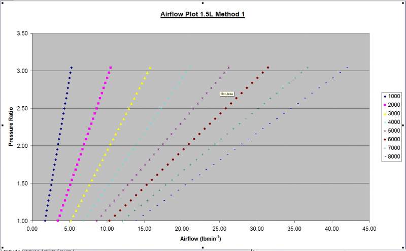

So I thought a 3-4 psi increase each turbo wasn't over the top. But should give me that little extra kick. And I was just wondering what other people where running.
Before anyone asks one of my turbos is shot and while I was changing them I thought I might as well do a few mods and get a little more power.

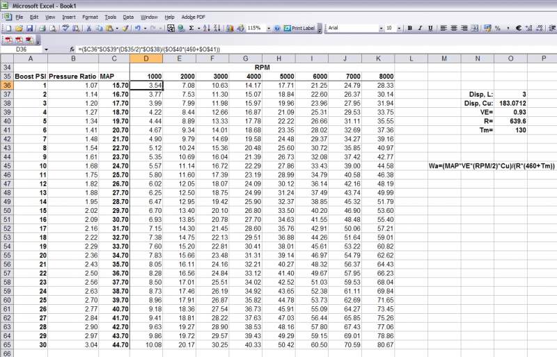

I should be getting 400bhp @ flywheel at this pressure . . . if my maths is right :tongue_smilie:

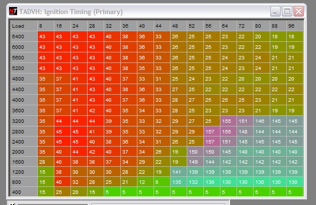

For information, here is a stock EDM timing map. The highlighted cells are the ones monitored for knock as standard:
When the knock sensor sends a signal to the ECU, separate knock maps are accessed (more fuel, less timing) as well as safety boost. Chances are there isn't much point in extending the knock-monitored regions due to false positives from engine noise. When mapping, I suspend all OEM knock monitoring and use an aftermarket unit and my ears. My old CA used to show knock readings in the hundreds using the stock sensor.

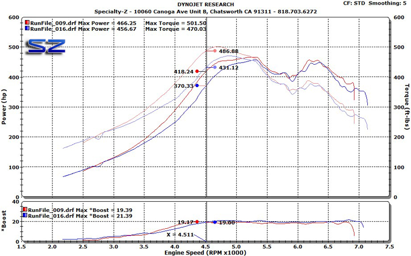

Pop down to the dyno at any time, and see for yourself :) Bring your car along to Santa Pod, and see for yourself :)
Before I respond to your post, let me suggest something regarding the highlighted sections. We're both traders on here, if you're going to question one of my posts, can you keep it respectful please? Let's just keep things technical and in perspective. That kind of rant is for the schoolyard and really doesn't prove or disprove anything, the only one "flaming" is you, I'm afraid.
Have a look around the internet for examples of people running 21psi on stock turbos. This is quite funny, because I'm not the only one. Not by a long shot :laugh::laugh:

We had a customer once who was running 21psi in a daily driver, bog standard engine, we checked all we could get to and nothing looked or appeared to be upgraded, the car went like a super missile and had no sign of detonation and seemed to lap up the boost No problem, I drove that particular car several times and could not work out how it was running how it did.
Later the owner had a small problem and posted up on here how it was running and was blasted for been incorrect and no one believed him, but we had seen it and it was real, a garage owner in Cyprus also came on here years ago and said how they had 500bhp out of a totally standard engine and no one trusted what he said, later on a trip to Cyprus I saw how it was done and its very possible.

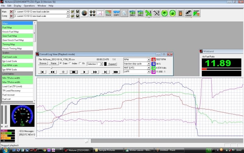

Well 15psi on a boot to the floor run ****ed my ring lands and my dat slogger shows injector duty at 100% before I'm ready to change gear!! Hence why i aint refitted a boost controller after the last one died :)
Data logger*
No.
It was component failure or improper mapping that destroyed your ring lands. Sorry to say, probably could have been avoided. Your data logger? SAFC2? Consult?
Here is some proof, which I have already posted, showing 21psi "on a boot to the floor run":
Let me break it down:
Red line = RPM
Green line = MAF voltage
Blue line = Injection duty cycle
Pink line = AFR
As is plain to see, duty cycle at 94% at an RPM of 5937 with an AFR of 11.89:1. I picked the highest duty cycle from the log to highlight. The MAF voltage of 4.574v is indicative of the power I was running. Z32 MAFs have a voltage output range of 0-5v. I will leave it up to you to work out how much power I was running. The reason duty cycle remains relatively constant is due to the fact boost tails off as revs rise.
Last time I left it at that, but this time I'll go a bit further into it. The 94% is actually higher than the true duty cycle. This is because I have reduced the injection multiplier by 6.25% in order to be able to have a lean cruise condition (16:1) without O2 feedback. By doing this, fueling across the board is reduced, yet it will still be reporting the original duty cycle. In order to maintain the original AFR throughout the rest of the map, fueling was subsequently increased everywhere apart from low load areas. This results in a reported duty cycle HIGHER than the true physical duty cycle experienced by the injectors.
In short, duty cycle was probably 90%.
Hope that helps :)
