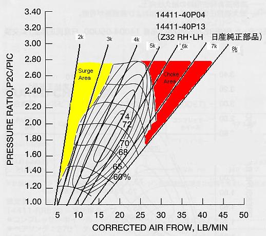

Here is the compressor map for the stock 300ZX Garrett turbochargers:
According to Garrett themselves: maximum boost occurs at a pressure ratio, P2C/P1C = 2.75.
(2.75-1) x 14.7 = 25.725 psi or 1.75 bar
With the number-crunching already done, (I'll assume it's correct):
This backs up everything posted in this thread with regards to running 21 psi. At 7k RPM, the turbos will be flowing around 1 bar as was observed
Airflow = BHP*AFR*BSFC/60. For 400bhp you need approximately 44lb/min airflow, with an assumed BSFC of 0.55 at all engine RPM & AFR of 12:1. I hit near enough that (394.4bhp) at 5800 RPM. Looking at the graph, this corresponds roughly to 1.2 bar and 23lb/min (46lb/min in twin turbo configuration).
So there you have it. Empirical data & theoretical data working in unison. There should not be any doubts left as to whether or not you can run 21 psi on stock turbos if you wish to. No reason why it can't be perfectly relaible as long as the mapping is spot on, bearing in mind the increased wear on the turbochargers themselves.
Stating that above xx psi the turbos "just blow hot air" isn't very accurate either.
If I hadn't observed the above for myself, I probably would have searched out the compressor map first....
Running maximum boost pressure of 1.7 bar for the mid range would probably see you with 450lbft around 4400 RPM. Assuming max BHP is attained

oHH, one month ago I tried to plot the rpm straigh lines into a turbo graph, but finallly, I made the data with error...
Could you tell me what equations and values do you use?
Here to help as always. Plus I'm a geek :online2long:
Please note that the spreadsheets show the airflow requirements of a 3.0L engine, whereas the data plots are simply halved for a 1.5L engine (i.e. specifically for use with compressor maps for our twin-turbo set up).
Volumetric Efficiency (VE) can be calculated for your own engine from data logs, where VE=(Mass Air Flow x Air Temp)/(RPM x Air Pressure). It is a parameter that varies with RPM. Here it is assumed as a constant 93% for all engine speeds.

These calculations can be used in conjunction with BHP & boost requirement calculations to determine or assess the suitability of any engine/turbo combination. The results above differ from the plot I posted before, but they all give a good estimation.
