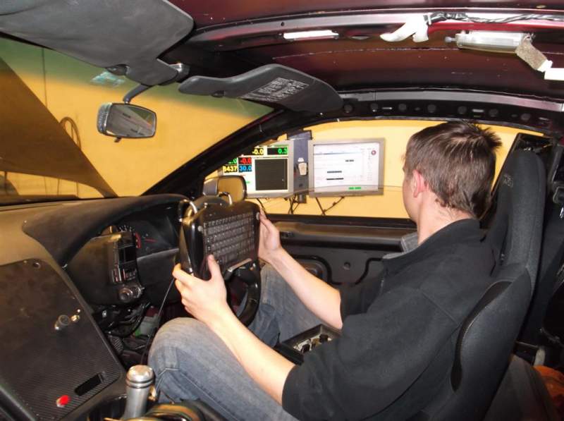

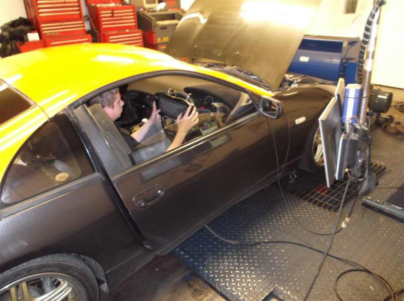

Wait no longer... Its mapped!
I had a really productive day at Emerald today.
Given that this is a stock engine from a previous "breaker " of mine I am well pleased with the results.
The headline figure of 232 BHP is actually lower than the figure recorded 6 years ago on my old slicktop (242 bhp)
Since BHP is a rather meaningless calculated figure Im not too bothered by the actual number itself. Most dyno operators like to "please" their clients with a good figure. Emerald are well known for producing "modest" figures.
Just look at the progression of smooth power all the way up from 2500 to 6500.
Just look at the torque it makes over the same range.
And finally check out the AFR if you ever doubted how good Emerald is.
The car feels really lively but on damp roads and with suspension settings all over the place I didnt feel confident to push it.Also this was the first run in six years on the road. Its now an NA manual. last time it was driven in anger it was a TT auto and it ended up in a lampost. I didnt want a rerun of Yaseens accident.
Here are a few pics of the day in progress along with the obligatory "graph"
