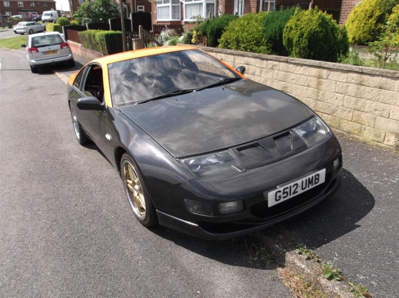

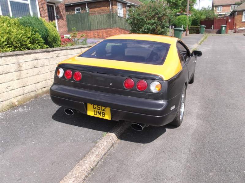

Six years later!!!!!!!!!!! Its got a ticket!!!!!!!!!!!!!!!!!!
It was nearly six years ago that Yaseen brought me his damaged slicktop .
After I stripped off everything he wanted I was left with a damaged rolling shell.
Today I took it for an MOT and got a first time pass.:thumbup1:
Just need to get insurance transferred to it and tax it for June 1st.
Its still a work in progress with lots to do.
Might have a run to JapShow at Santa Pod.

grats bud, i remember seeing this in your garage when it was parked next to your 240z. i take it you decided against going with the orange look? was quite looking forward to that.
What happened to the other set of wheels?
cheers Ian. I only ever had in mind painting the roof and hatch with the Electric orange .
Im not sure wot wheels you saw on it . I have some Japanese split rims (17") deep polished lip and dark centres like the car..
i also have some cheeepo Woolfrace 17s . also just acquired a decent set of Fox Rs 18"
May need to part with something eventually.
I like the wheels it sits on now but not the gold centres. They used to be on Bobgenies convertible.
Hopefully I can get a bit of "on the road" mapping on the Emerald before bringing it to Japshow.
Great news Pete. Now it's time to start enjoying it. And as we all know, even in this weather, Slicktop's Rule :rockon:

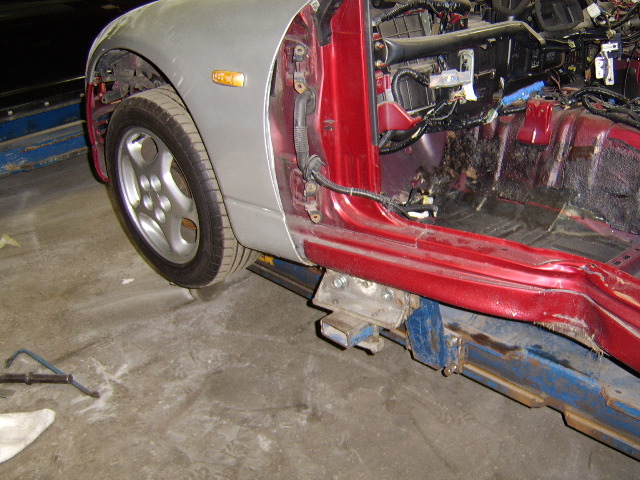

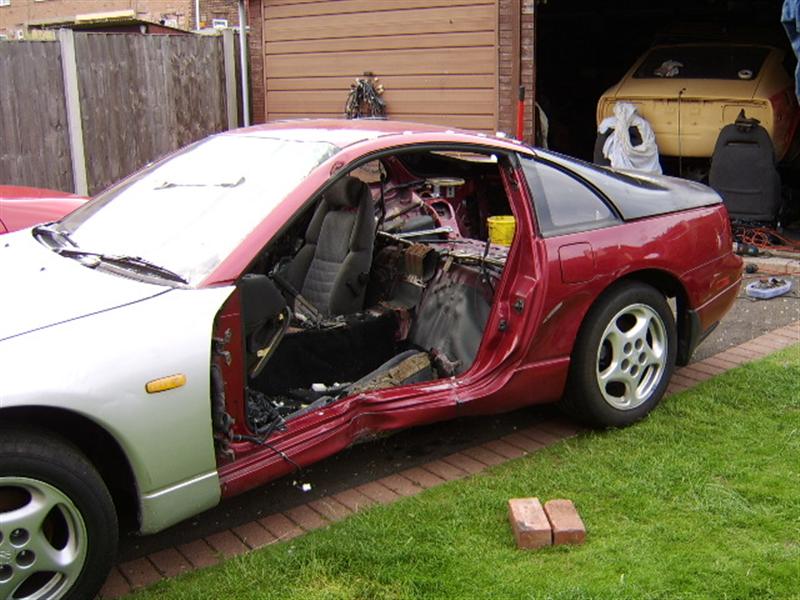

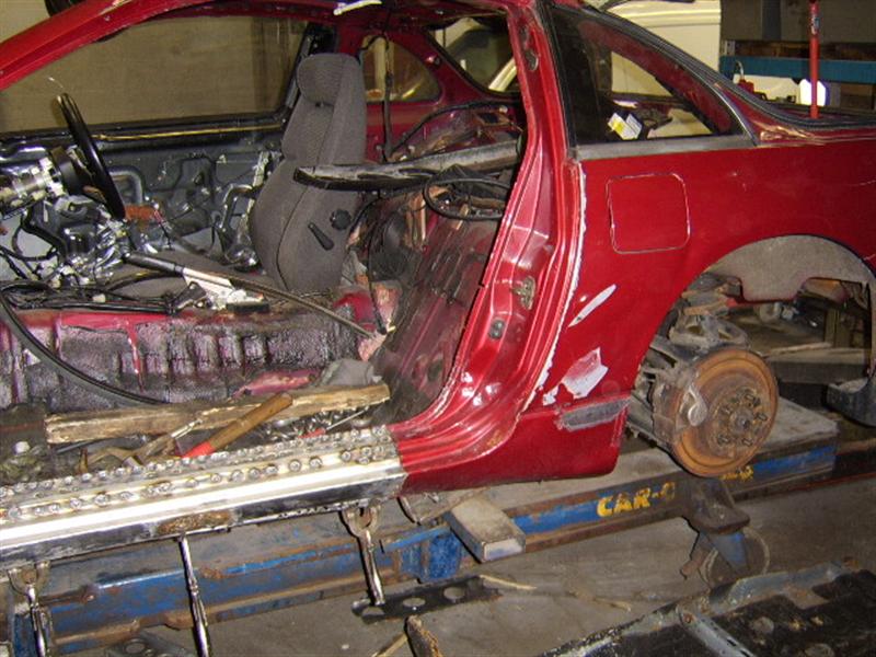

Here is where it all began......................................
It was VERY bent:blush:

bloody hell thats came a long way, take it that was a jig that got that sorted out.
It was on a very big jig with a highly skilled operator(of God like status actually)
Lots of the story of the build is in the NA tuning section.

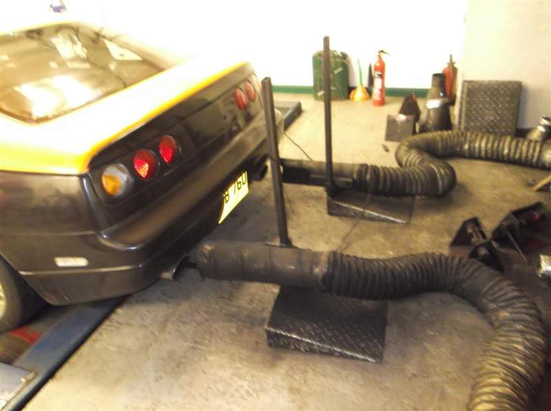

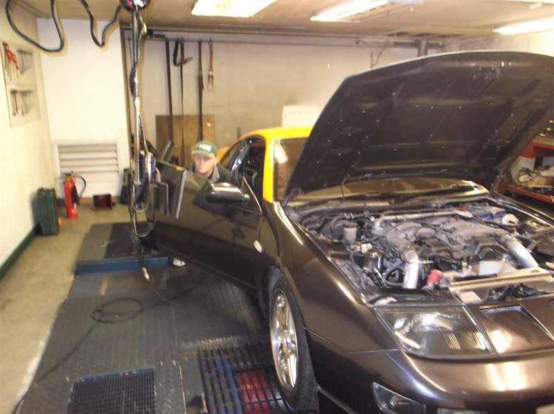

My mate John who MOTd it did compliment me on the build .
Emissions were spot on . Brake balance and stopping power were awesome. L to R balance was virtually perfect. I only had to adjust one headlamp for him during the test.
