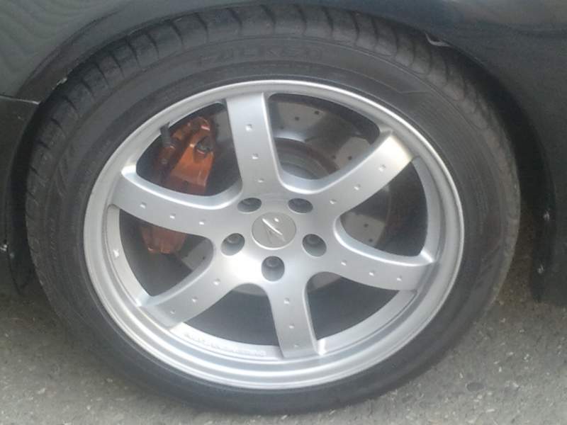

Heres my front setup, complete with 350z forged 18" Rays
