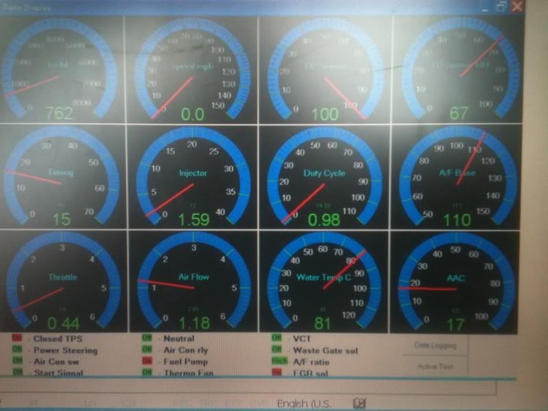

yes.... but your idle is too high!!!!!!! that will not help things in the long run...
follow Steams advise and clean the IAA, it's not hard to get it off... but you will most likely have to get/make a new gasket for it....
once you get that sorted and the idle adjusted down to the right level you can get some more readings and see to the O2....
Okies, I'll clean that and turn the idle down a little to 750. And take another reading with the engine up to temperature

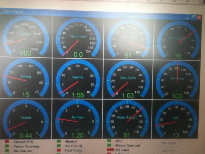

Thanks guys, changed the idle as best I could but it's a little up and down but you can only see it on the datascan. The cars clocks look fairly static. I will do the IAA when I get the chance. How does this look now?
I revved the car up to a bit over 2k as well and the rh O2 sensor wasn't moving much. Will put a video up later showing that.
