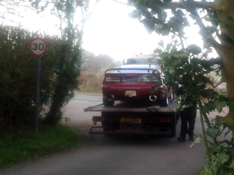

Thanks guys, parked my car up in the double garage in December for a nice rest and keep warm, 3 months later get it out and bizzare but the auto box which has worked with out any faults during my 10 years ownership was whining and not at all happy delivering any decent drive!! never mind I have a new gearbox with 5 gears and a third pedal waiting at the workshop, what a stroke of luck the white breaker I bought a few weeks ago has a well quiet and slick box...so its official Jeff TT is going manual!!!!! oh any tips or advice welcome. :biggrin:

Well nice cherry red fluid and lots of it, its clear though that the strainer is blocked hence the noise and lack of drive, speculation at the moment is the brake band drum had some surface rust caused by condensation inside of the autobox and this caused some of the band linning to rip away when I started the engine and eventually found its way to the strainer, I have loved my autobox but time to go as they say......the gearbox not the zed!
