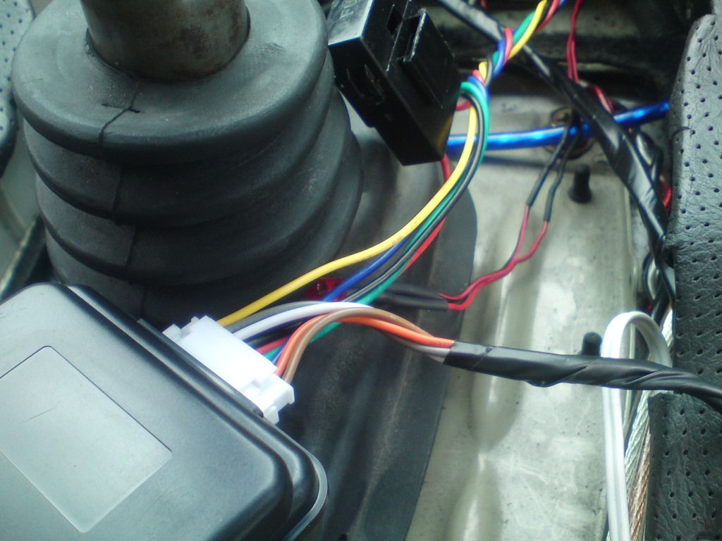

I have fit mine and I am going to tell you which coloured wire goes where, this is the four wires connected at the switch - quite self explanatory these. FYI, instructions are included with the module.

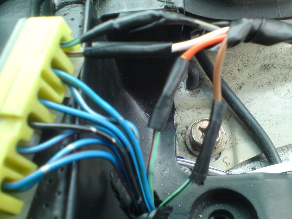

In this next pic you can see the four shooting off that go the switch itself, that leaves the 5 wires still to connect and these head towards the in-line fuse and away out of shot.
Yellow wire needs to go to 'acc on' or ignition live, the red to a permanent live, the black to ground.
That leaves two wires, Green and Blue, these are your trigger wires, on mine these are joined together and go to the window closure module that is linked to my alarm.
