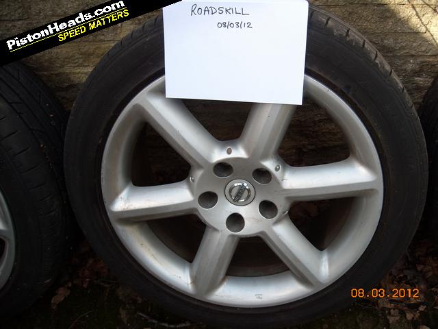

They are from a svx 8x17"-5x114+45 with 235x40x17 tyres all round,but as was said earlier the centre hole maybe wrong but being non original they may have a larger centre than the svx wheels,but with a +45 offset they might have been OK.but that I will never know as I cancelled the sale and got the 350Z wheels which are 18" and it has now been said these won't fit either without spacers GRRRRR
I did look at all the other threads from others on the forum but didn't see any mention of clearance for 350z wheels,not much of a problem as far as I can see though,they are standard Nissan made 8x18 offset 30 in very good condition and only £100 with potenza 225 45 & 245 45s 5mm tread left so if it cost a bit more I won't complain.

these are the wheels

Well the wheels are on with no problems at all the clearance from the spokes is about 12mm so I don't know what the scaremongering was that I would need 3mm spacers or grind some off the calipers
