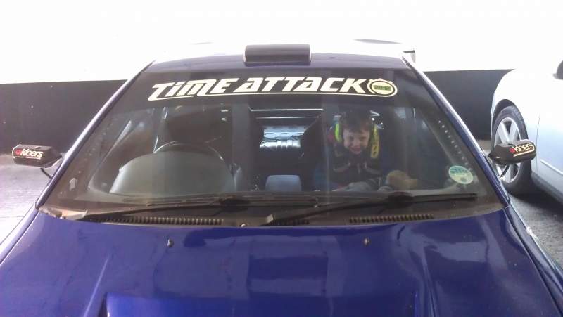

I'd even taken a quick snap of my new brakes (couldn't fit as the wheels wouldn't clear!!) and put most of the stickers on.
Here's my little boy helping me move the car on Friday morning to load on a trailer, the new brakes and all loaded up ready to go to Cadwell
