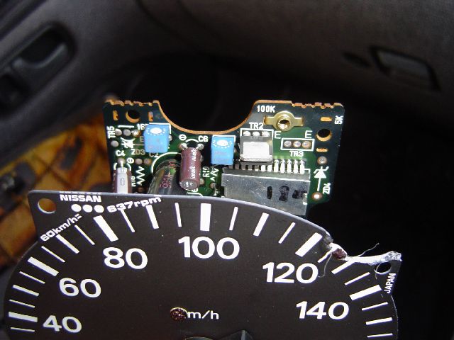

1 The dial-side of the speedo PCB. The small area in the middle where it says "R10" next to a squiggle is where the old resistor was. Note the artistic new curve incorporated into the speedo dial on the right...

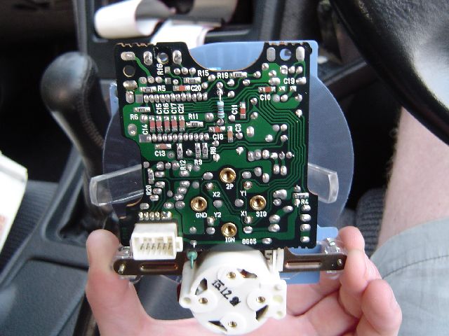

2 The rear of the speedo PCB. Near the top, in the middle, you can see the new light-blue resistor which I found was much easier to mount on the rear, but then I'm no soldering expert (which explains the modification to the dial ).

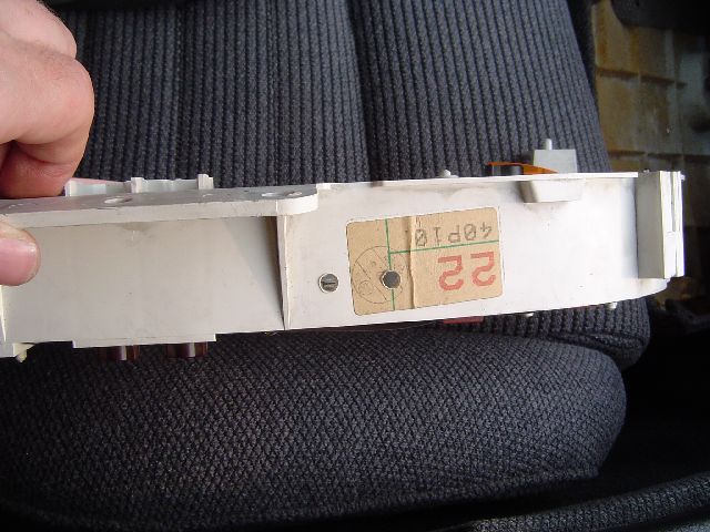

3 The location of the holes in the clock mounting. The scale pot is the one on the left as you look at it.

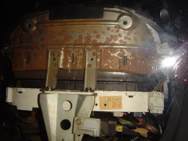

4 Ditto with the clock assembly in situ.
5 How it looked like from the dial side, with the screwdriver in tweaking position (NB scale pot is now the one on the right as you look at it).

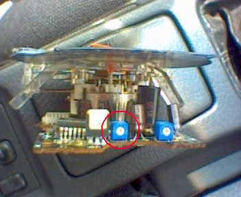

so the one with the red circle you adjust? why is he going on about resistors another job??
according to the post's yes but i still think we are going to have a problem ... will let u know if there is a problem . i can only do 30mph on the privet rd beside me as my car is Sorned till the end of the month

the origonal thread is about changing a kmph clock to mph without using a converter. it involves changing a resister then fine tuning by adjusting with a screwdriver. you could do some maths to work out a different resister value, or you could ignore that bit and go straight to the adjusting with a screwdriver
