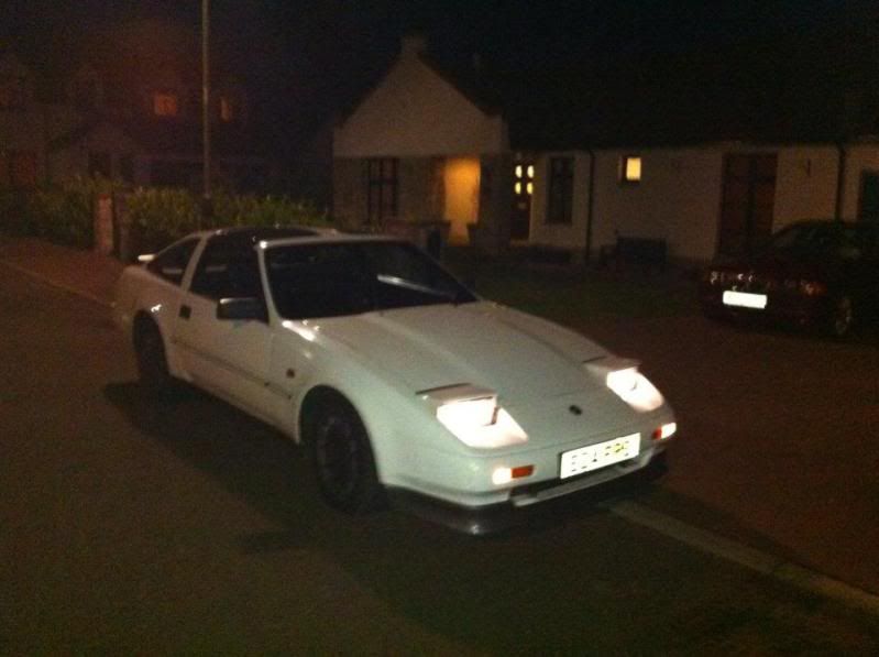

i just bought an '88 z31 turbo today. on the way home it was fine from glasgow to dundee on the m'way then going through dundee the temp guage went up to the three quarter warning mark and it started blowing cold air through the vents. then back o the dualler it went back to normal but the oil temp. guage went up a notch.
then i got to the country road that takes me home and the water temp. went back up and the cold air started again. and it was doing this on and off when i took it for a run around town.
its got a pretty bad misfire that should be fixed with ht leads but has anyone got any idea what the crack is with the temperature lol?
and please dont say something expensive lol

as said mostly z32 owners here not many z31 so zclub is a btter bet or the us 300zxclub.com i would suspect from that you have an air lock or poor circulation withon the block.
Sounds like air lock coupled with low coolant level
Sounds like what i had with my z32, might be an idea to change the old coolant pipe work as well as mine was letting air into the system but the cracks were not big enough to let water out.

could be as little as a coolant problem or as bad as needing a gasket kit. you'll just have to have a look and let us know your progress as i'm interested in the faults and finding them on the 31. cos i'll be getting one also.
hi mellow yellow. it was low coolant and its leaking water. im yet to find out where from though.
that will be it then if the 12v vg is anything like the 24v vg in ours then you will need to jack the front end up to bleed the air out the system otherwise you will get hotspots then boom. i would run the engine up and visually check over with the additive recommended then look at the dry floor for spotting. then trace it up. get some pics of the beast up i like to see z31s id hav eobne if i could have two toys
More than likely just a brittle hose that's split from the cold weather. I had a scare with mine last year, there was steam near the windscreen so I opened the bonnet and it looked like it was leaking at the gasket but when it cooled down and had a chance to get it inspected it was just a brittle coolant pipe at the back of the engine bay that had a small split and was spraying the coolant off the back of the block thankfully.
