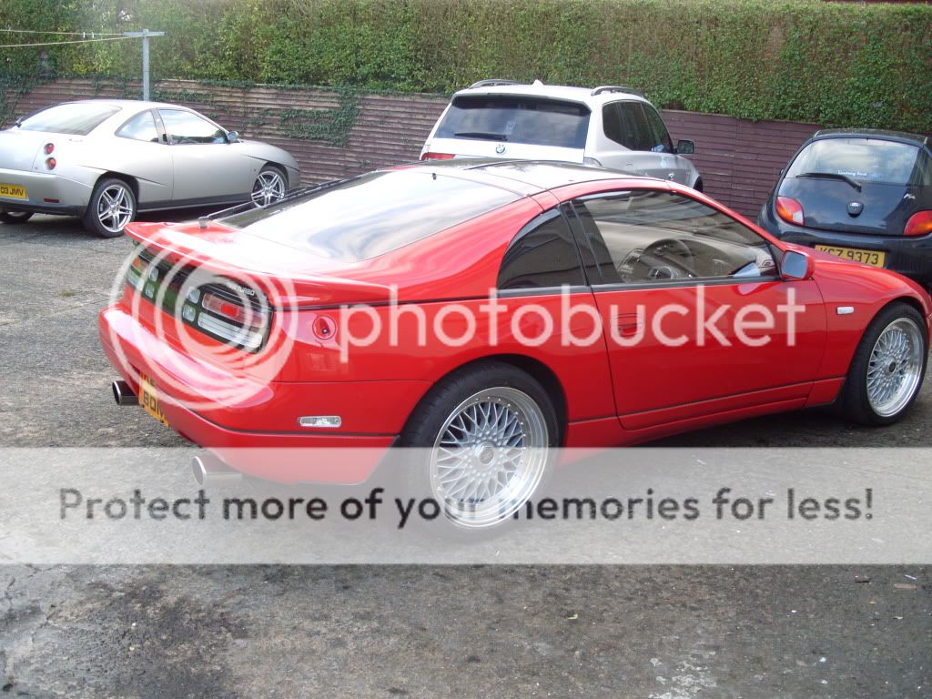

Front stance
Andy has got his spot on at the front
As have a few others. How do you get it to look like this without rubbing.

well thats andy car isnt it hopefully he will be able to answer but ive been wondering this also as even at my ride height not that low it rubs on high speed corners.

Hi Bud,
That did look good but rubbed occasionally (arch liner screw heads)so I changed the 25mm spacers for 20mm but I can't remember the offset of the rims!
A little trick I did was to gently bend back the tabs that the arch liner screws go into. You can also take 1mm off the heads of the screws. This doesn't sound like much but it helps.
Word of warning though - you may crack the paint on the thin edge of the arch if you don't heat up paint as you do it. Also you may crack it and not realise so apply a little clear lacquer on the edge for good measure.

Yeah ive done the tabs on mine, mine is rubbing on the front of the arch liner so i know if i space my alloys it will rub like a :censored:
My slicky is ok like this but with my old springs on it sat slightly lower and rubbed like hell!!
