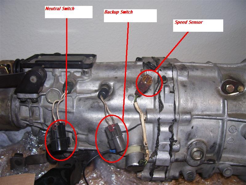

picture? manual box.
does any 1 have a picture of a manual box showing what each plugs job is ? i figure one is the speed sensor the one near the gear stick is the reverse switch but what is the other plug ?

Connecting the neutral switch to a pin on the ecu, seriously dont bother. I did this and it advances the timing everytime you put it into gear and of course then raises the revs slightly. I got sick of this, so cut the wire at the ecu end i had connected and all good.

There is no detriment by not connecting it, so make life easy for yourself and dont bother, just my opinion though lol
