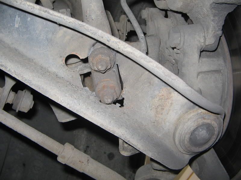

check the lower arm where the two bolts for the tension rod fit. I've seen a few rust around there causing a bad creak, scary stuff if you leave it!
Thanks gents, I better have a look at it asap. Some of those pics look scary!

I whipped the wheel off this morning. No sign of any corrosion as pictured (thank god!).
