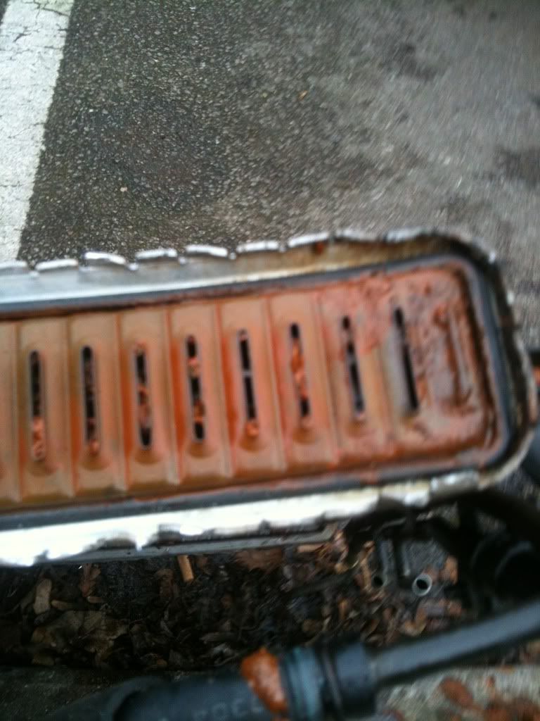

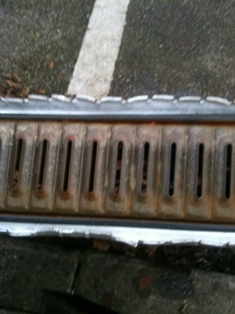

Well think this should explain my over heating problem
And......
to say the radiator was blocked is an understatement, about 3 channels halfway up and 5 at the top were available to get the water through, what gave it away was what A2zed (member of the Aus300zx site) mentioned that the bottom hose will collapse on its self if there is flow restriction, which it did when i got it to start over heating earlier (yes i know inducing over heating for the purpose of testing lol)
So out came the old rad that sprang a leak, i was lucky that the leak was due to the clip system on the side that holds the oil coolers for the autobox, 2 had pride them selves off the casing, so i eased them back into position with a hammer and chisel, refitted everything. refilled the system checked for the rad leak which was now none existent, seems there is still a slight air pocket in there, but going to bleed it again tomorrow and im so glad i didn't throw the old rad out.
Temp stayed at 84 degrees, crept up to 88, been as high as 89, but when giving it a bit of boost and driving it above 50, it actually cools down to 82 degrees now, and i have hot air that doesnt fluctuate :) and when pulled up she settles to 84.
88 and 89 temp achieved when idling for a prolonged period with the heater off? so i still think there is a trapped air bubble in there somewhere so will re bleed the system tomorrow.
Will still need a new rad as i don't trust the one i put on (due to old leak), just did it to see if it was indeed a rad problem, got a bit worried when i stripped the old one down on one side and saw it looked clean as a whistle, until i stripped the other side out. couldn't even see through most of the cores.
will be keeping an eye on it for now though to make certain. have to admit though, its the coolest my engine has smelt in a while.

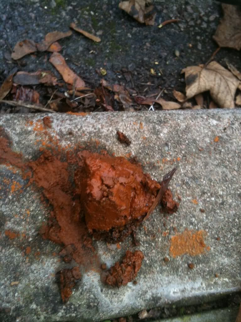

You wouldnt believe the size of that pile of crap in the photo, the photo makes it look small, also trapped in the channels that id removed before taking the photo were old bits of orange sealent used by nissan to seal the waterpump and water pipes to the block

It looks like it was filled with radweld at some point in its past. think mine might be like that to.
thats not rad weld, its rust build up from a 20 year old radiator, its more a clay type substance that once dry will go powdery.

Did you crap yourself when you saw the rad :D
Only joking, my car has the exact same thing. But i dont have any problems, yet!
