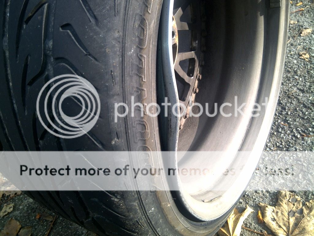

Uhhh dude you need to get higher profile tyres if you are going to stretch 255's, that concaved sidewall is a tyre pop off waiting to happen.

Always horror stories, mostly from things like my above post of people trying to stretch tyres that are of a very low profile, 265 35 you can get away with but something like a 255 needs a 40.
You are absolutely right of course, the profile on those tyres (rather than the fact that they are 255s on a 10" wide rim) was too low and hence those rims aren't on the shortie' anymore....
though I blame the road works that buckled the inner rim for the tyre coming off....possibly due in part to the low profile :whistling:
you are absolutely right of course, the profile on those tyres (rather than the fact that they are 255s on a 10" wide rim) was too low and hence those rims aren't on the shortie' anymore....
Though i blame the road works that buckled the inner rim for the tyre coming off....possibly due in part to the low profile :whistling:
