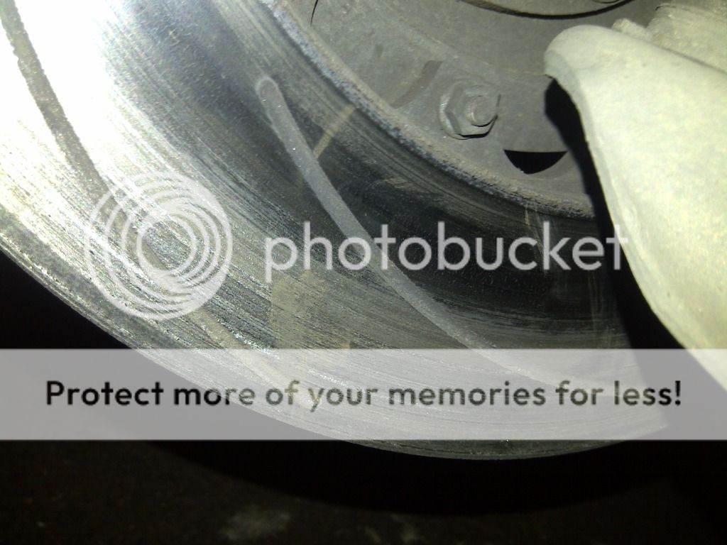

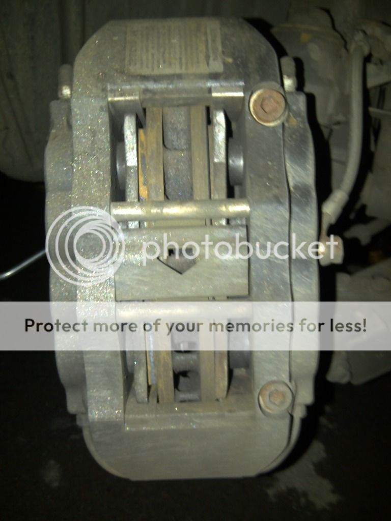

Well there's the problem.....
and the gouge on the inside of the disc
It looks like the bottom part of the inner brake pad has worn away completely but the top part of the brake pad isn't too bad
Is this a piston problem perhaps?
I'll be swapping the lot over on the weekend I think
yeap you higher piston is a jim jammy by the looks of it, not completely look at the pad wear, take pads out and nip iff the dusts seals clean the pistons up, take the cap off your brake resovoir and slowly push them in all the way with a g clamp, should free them up, and wont require a rebleed. you'll need to get that disc machined and do the other front and new pads at the same time.
