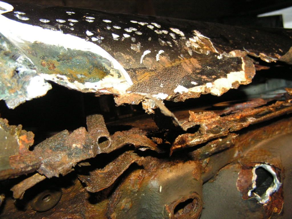

Whilst out today fixing a hole in my sump and painting some of the underbody, I prodded what I though was just loose flaky rust, next thing I know I have a huge gaping hole along the whole sill.
I have skirts on, so its hard to tell, if this is the side of the sill or the actual bottom of the sill itself.
So...three questions -
1 - Is this fixable, can it be welded and if it can be welded, is it a huge job costing many hundreds?
2 - If welding is possible, will the skirt need removing?
3 - How safe is this, is my drivers side floor likely to drop out; killing me?
Thanks all.

The link below might help you with your decision,
Mine was very similar. :excl:
It was a matter of "do it myself" or give up on ever owning a Z.:no:
4 years later I am back up and running.:w00t: worth the wait.:thumbup1:
http://www.mig-welding.co.uk/forum/showthread.php?t=15465

I've just done this job matey, my skirts were blended in so there was no way of removing them,
i cut a huge chunk out of the rear wheel arch so i could see the damage all inside the sills, not good at all, i then had to weld in that tight space
as stated on here it didnt have to be the tidiest of jobs as you dont see the sills at all but the most important thing is that there structurally sound,
brace yourself when you first cut into your sill for a look as my inner sills were non existant, and then having to cut back again into good steel for welding onto,
i was able to do this job myself as i do a lot of welding at work, also my father is in the bodyshop so he gave me some tips,
one thing i had to do was cut a section out of the bottom of the side skirt, i was able to repair this and spray it and is now un noticable, i will try to get some pics up if you like,
it is possible to repair as i used my own steel thicker gauge
a body shop to do it would be quite expensive i would say, any help matey just let me know

I would repair it, then i have repaired and made parts for worse jobs than yours mate, Im an engineer and body repairer/mechanic by trade although i no longer do it for a job. I would pull your carpets up and have a good poke around before deciding on what you will do, there are good welders out there that would take on this sort of work. the floor is fixable and so is the sills and inner sills. It all comes down to how you feel about doing it and how competent you are if you decide to do it either way if you do it is a good learning experience for you.
yes a bit dangerous shame you live so far away i could have helped you out .welding wise....help you save some money
