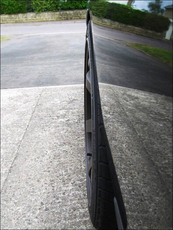

My rear setup is the stock arms set to their max negative camber. That's it.
9.5" with 265's on a offset of 20.
So 35 should be cake.
I believe the scientific term is "Hellaflush"

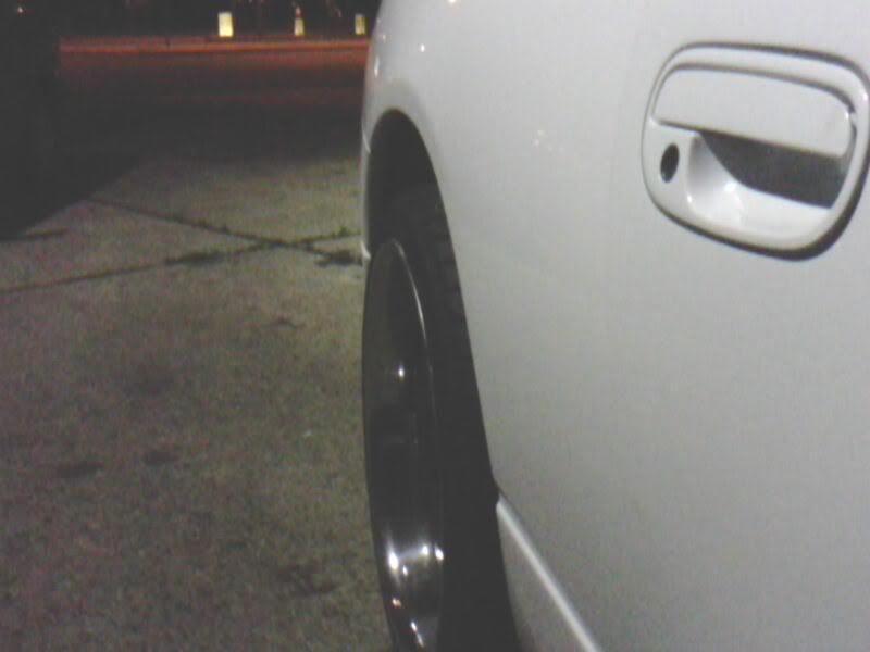

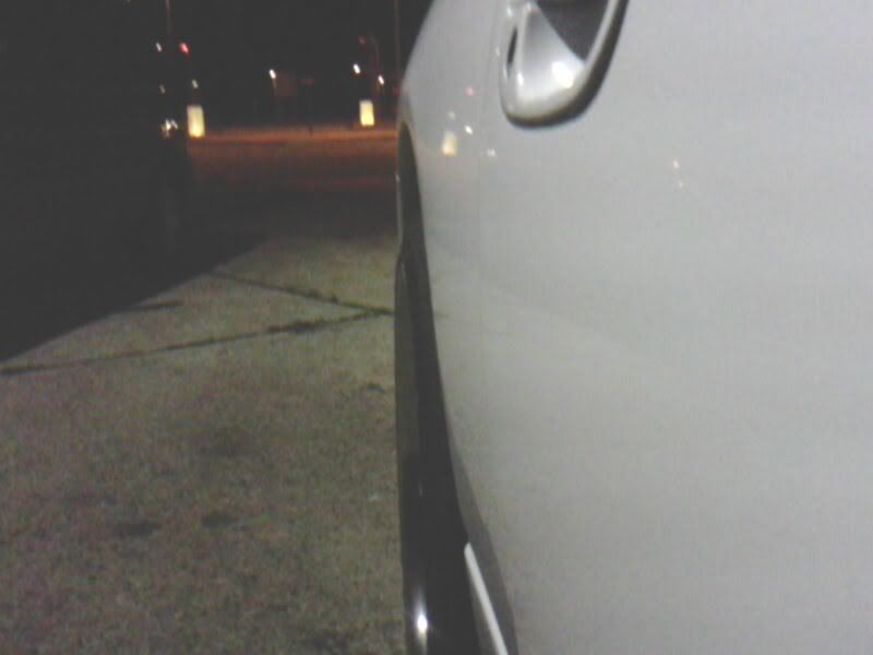

thanks everyone,
Try adjusting camber, and see how it goes,
so with a 9.5j et35 do you normally have to play with arches cause thats the one thing i dont wanna do if i lower it,
That door handle is sticking out quite a bit!
Nothing a :smash: can't fix.
Was u joking about door handles, i always thought they were sticking out too,
but the black seal around it all seems flush,
in the end i thought thats how they must be,

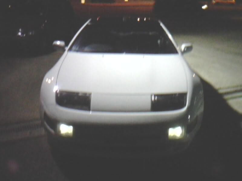

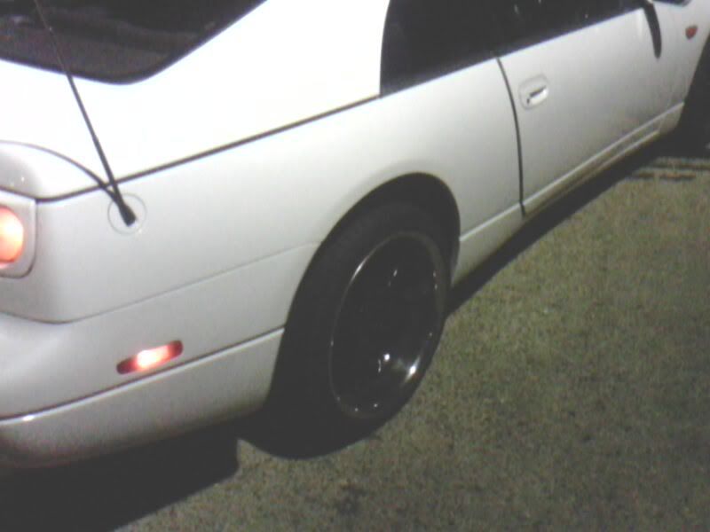

SORRY THE PICS WERE IN THE DARK EVERYONE, AND NOT VERY CLEAR.
That was the other thing i nearly forgot to ask done a thread the other day about ride height on standard setup,
im sure the rear never use to be so high can get 4 fingers between wheel and arch the gap seems massive,
i know when you jack them up they need to settle and it does a little but how it is in the pics is how high it normally sits,
The front sits a lot lower in the arches,
cheers
