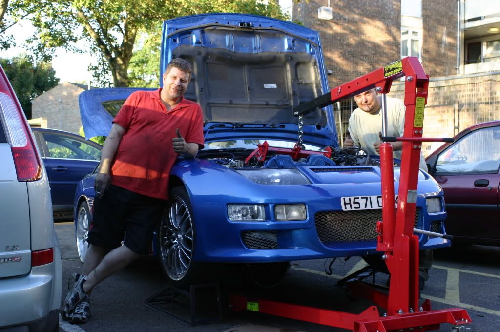

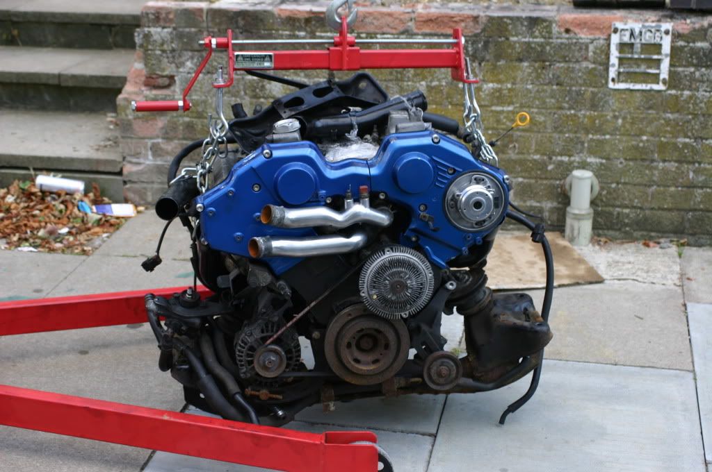

Well thanks to Steams, top bloke i must say. forgot how high the car would raise on standard height suspension, so had to pop the engine back in and adjust the load leveler, plus get the hoist lifting on all chains, these pictures were taken before id done that, the last well being taken after.

The start
the work area lol
The fit
the lift
the end :lol:
sweet. next up, fit everything back in and get the welding sorted out :D

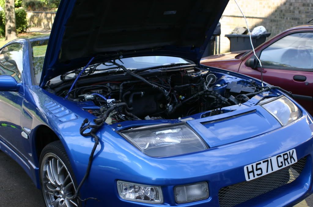

been concentrating on sorting the engine and gearbox change, but some good news, engine is now in the car, bad news, forgot to put the bloody wire on the det sensor lol, good job i haven't put the gearbox on yet and there is no EGR valve in the way so should be able to get to it to fit the connection on.
job done

laugh away fuzz balls, the engine came out, the new one went in.
with only a slight bit of paint scrape on the front bumper where the engine wanted to drag the hoist through the thing.
other than that, perfect.

ive got a polished plenum going on, just didnt fit it during lifting, will go on once the gearbox is connected up to the engine.

the new engine came with the sub frame attached, i left it attached until we were ready to drop the new engine in, as not only did it protect the oil pan, it also protected the front crank pulley, and when the engine was lowered to the floor, it sat correctly.
we then undid the old sub frame, and lowered the engine into the bay onto the sub frame that was already in place.
one thing i will say though, if you can take your front bumper off, it would be a good idea. as i couldn't, i ended up with the crane being pulled into it with the engine.
