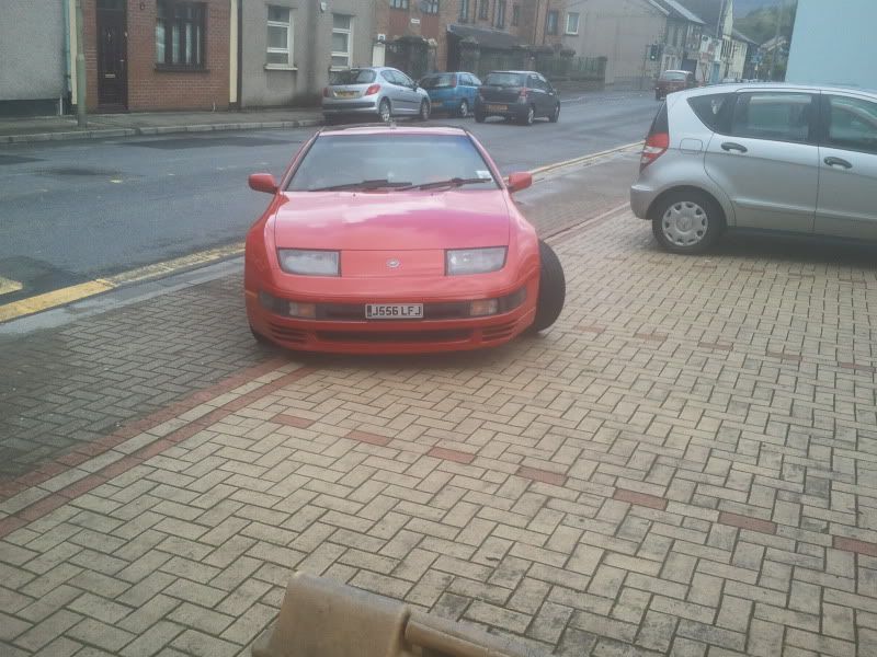

well i had a knocking and cluncking noise for a while and also the steering wheel going off center and this is what happened to my arm about 3 mile after i had the car jacked up. the steering going off center only happened after i had the car jacked up.
if i get chance ill post a pic of my old lower arm so you can see what to look for. Also do you have polly bushed tension arms?
Think mine is all original as well.
