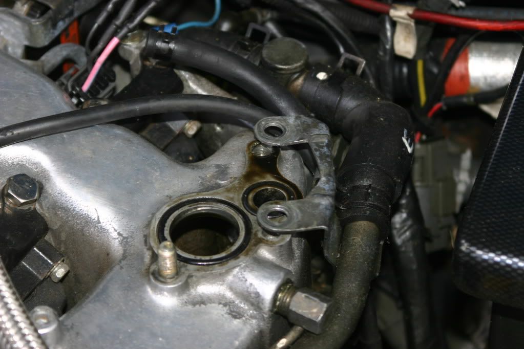

new engine is here, so thought id get cracking on removing the EGR, anyway noticed that my turbo elbows had studs snapped with not enough on them to get a bolt on when it comes to putting the exhaust on.
So decided to remove the elbows while i was there, to replace with the ones of my current engine, the two nuts holding the elbow on at the bottom, came off easy on both sides, the two top bolts on both sides how ever, just snapped with little to no pressure being applied. so now the only way i have of securing the elbows is with the lower bolts.
Short of taking the turbos off and changing the housing over for the outlet and as im crap at drilling things out, what are my options? :( (PS although i have a drill, its a bit crap at the moment as the charger broke for it so i cant charge it up)
Also what can i safely remove from this side of the engine, it seems when reading it from the forum i understand what needs removing, but soon as i get to the engine, it all looks a bit confusing lol

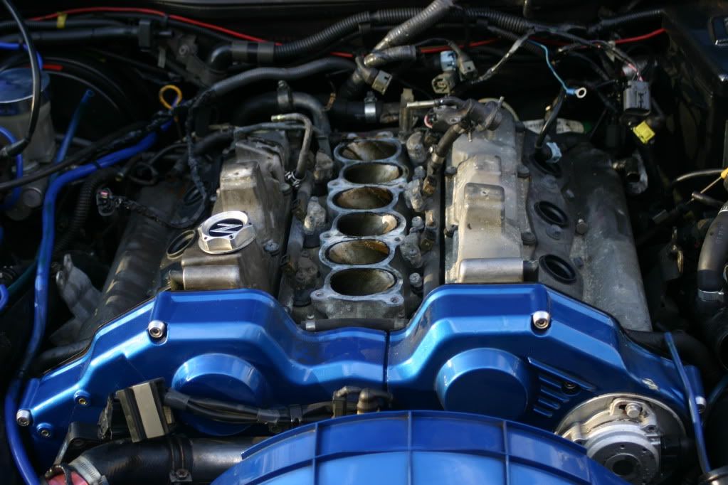

Anyway, plenum is now off the car, what a fun job that was, but found a nice hidden surprise. it already has EGR blanking plates on it, though the EGR is still bolted to the back of the engine so naturally assumed that it hadn't been deleted.
going to give the plenum another polish before it gets put onto my new engine, or get it chromed if i can find a good place to get it done.
going to put the old plenum off the new engine on the one in the car for lifting purposes.

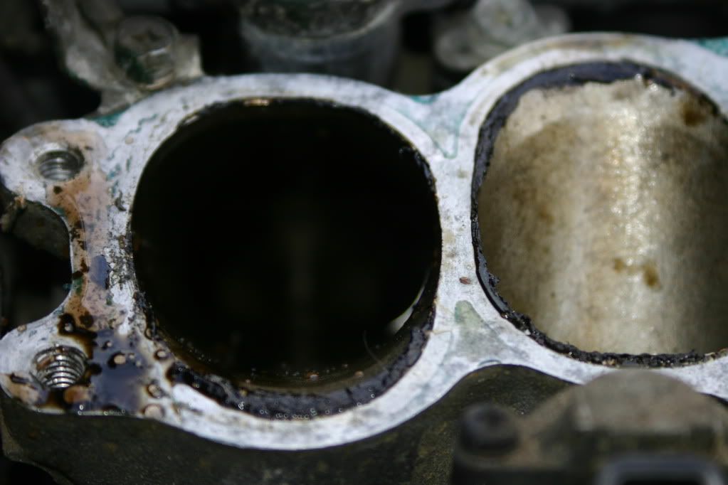

Loads of oil in the plenum, also loads in the intercooler pipes, something doesnt like the oil being in the engine lol
snapped bolts in the turbos are a PITA it is a very fine and long job to get them out as they will be stuck in pretty well. tick a pic up of how much bolt you have showing and then it changes the options you have. You can either struggle to get them out for a while and maybe do it or get the tubs off and take them to a workshop to have the sheared bolts removed.
Ps where did you get the oil filler cap from?
turbo oil seals gone
well yeah, but also 5p size hole in cylinder 6 doesnt help lol
