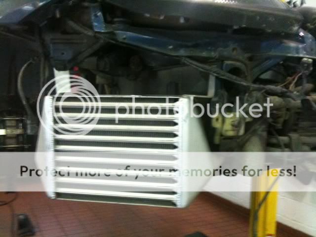

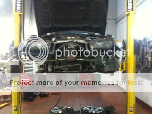

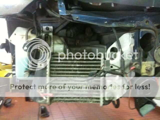

Started to get it stripped down today - pic of the stock intercooler in place:

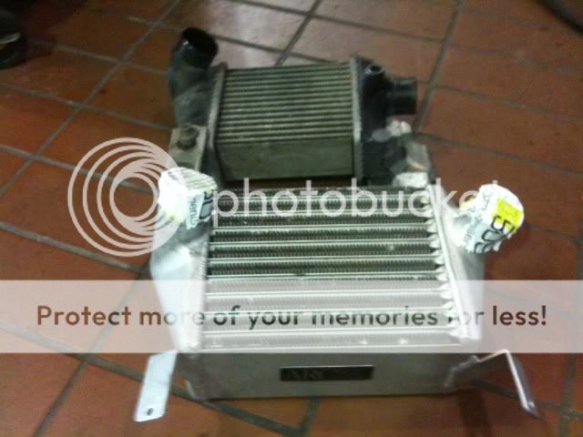

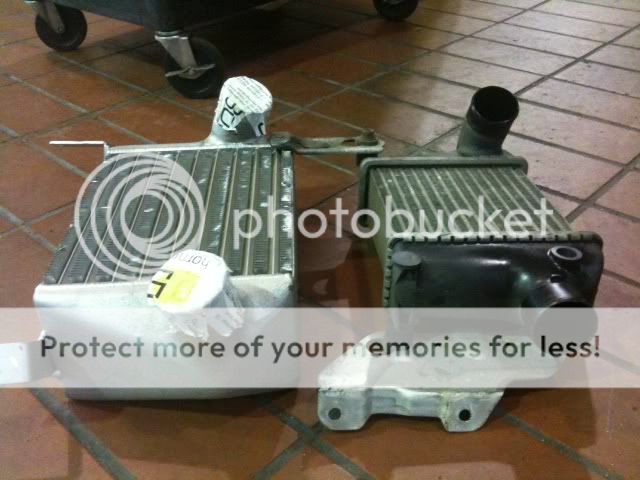

Couple of shots of the stock v ARC intercooler:

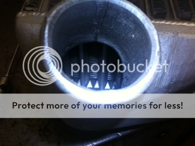

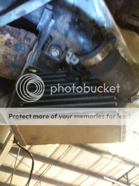

One thing I have found out is that one of the outlets is angled on the ARC intercooler as opposed to the straight outlet on the stock cooler - this means I am going to need to get some straight coupling pipes to fit the new ARC cooler to the stock hardpipes on the outlet side.
ARC intercooler in place:

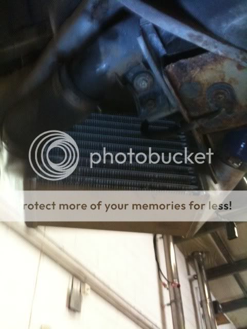

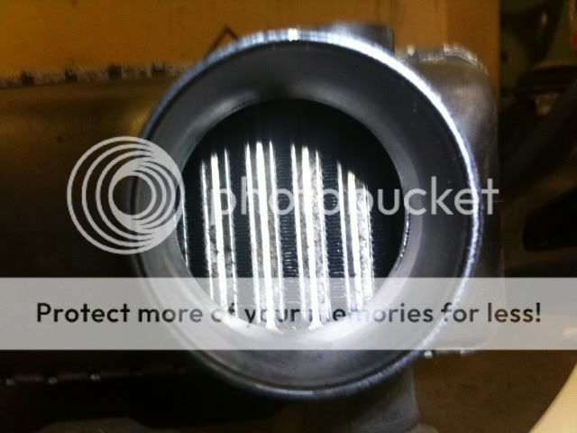

The main thing that amazed me was how restrictive the stock core is compared to the ARC core - I took a couple of pics but looking at it in real life it really is quite a difference!!
Stock:
ARC:
And a shot with new ARC on one side & stock on the other:

Lurvely mate, best performing SMIC on the market due to their core design and slight difference in outlets :2guns:
smithy
Very nice Paul, I got some ARCs for mine last year and they are one of the best mods I have done, instantly noticable increase once you've got better flow in and out. :thumbup1:

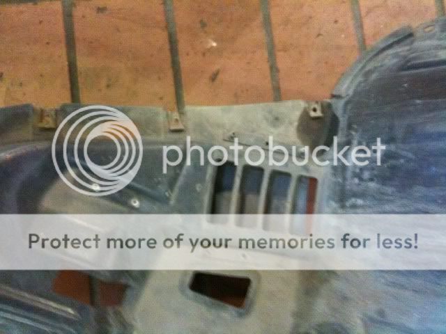

Could I ask a huge favour, are you able to take a few pics of the ducts for me? If I know what the proper ARC ones look like it'll help me get some made up :)
just noticed you got rid of the standard washer bottle :rockon:
no probs - will take a few pics tomorrow - you can see a pic here on the for sale thread: http://www.300zx.co.uk/forums/showthread.php?t=151837

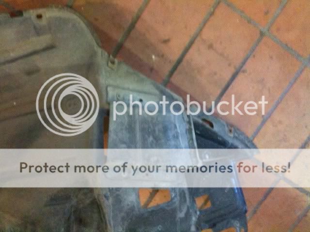

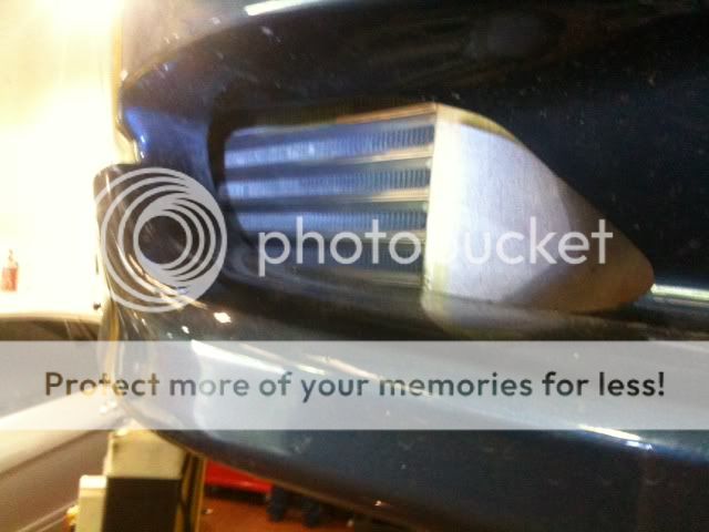

With regards to the ducting I have found out the ducts are for Stillen intercoolers & not ARC ones - the ARC IC's are so big that they are angled away from the centre & do not sit as flat as other IC's - they were supposed to be modified to fit but the angle is too far out & there is so little clearance that I dont think there is too much I can do with them - I may be able to adapt the inner section which seems to be the only place they will fit - they sit so close to the bumper there may not be too much need for ducting as most of the air will be forced through them anyway!
Pic of them with the bumper attached:

only had a bit of time tonight after work so intercoolers now all fitted & connected fully.

let me know if you decide to get rid of the ducts... maybe they'll go better with an earlier type bumper?
Hi Baz - they are Stillen ones for a 99 spec bumper - as said they just wont fit :no:
I may still be able to chop them down as really its the inner part that needs the most ducting so I really want to adapt them somehow
The arcs just sit too far of an angle & this puts the ducts in completely the wrong place if you just mount them on!
