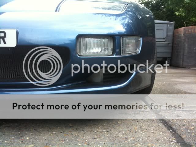

I have a 99 spec front end - not sure if that would make any difference?
