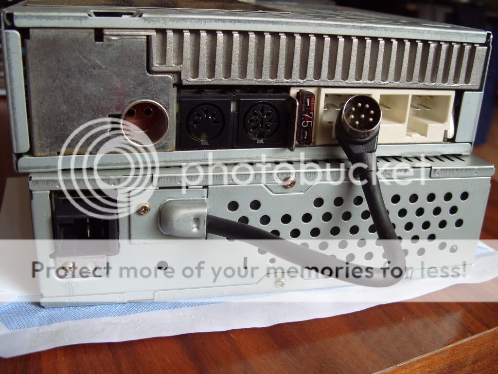

Do your units look like this on the back:

And what did you have in there before?
OK. Did the rear speakers work OK with the Goodmans unit?
OK, I'll try to post more in a while but IF the rear speakers work OK with the Goodmans but are only very quiet with the Nissan, then someone's bypassed the rear speaker amp. On my S3, a "normal" Sony head unit gave normal vol out of the front and very loud out of the back. Took that out and put in Nissan, normal vol out of both front and rear. Of course, the Nissan units are designed to use the rear amp so this is what you'd expect.
If the rear amp has been bypassed, "normal" head unit will be OK vol on rear but Nissan won't be giving enough drive to the rear speakers without the amp it's expecting to be there.

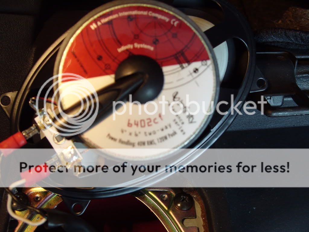

Ahah. Got a pic of that somewhere but in the meantime, take out your rear speakers and see what connections they've got. At the dash end, are you certain the rear speaker feed is going into the harness OK and there aren't any odd-looking bypasses? If not, that would finger the bypass being at the amp. Hang on a tic.

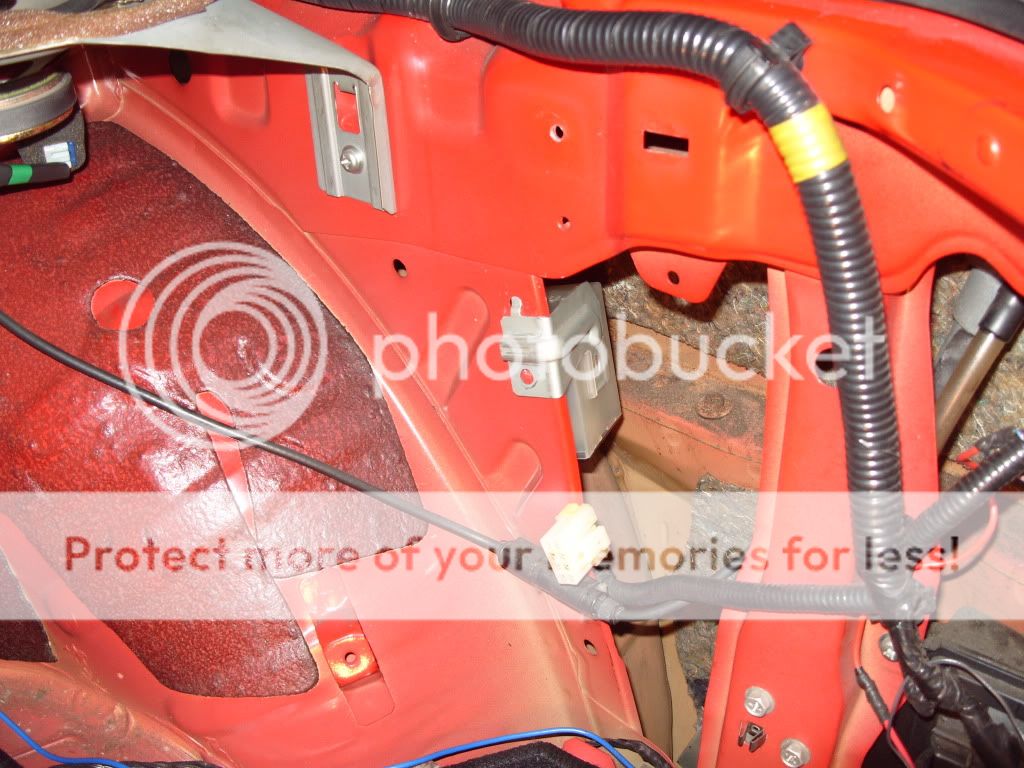

Looks like it's next to the ABS actuator. There are differences between the JDMs/Europe etc but so far, this is the only reference I can find.

OK. I'll be interested if you get a chance to confirm / have pics. Like a dimwit I lost the pics I took after I tidied up the S3 (which had standard connectors like yours) in the centre console. And I've never found the rear amp phsically - just got my S3 one back in operation by taking our all the bodged wiring and putting back the OEM stereo. The 1996 workshop manual doesn't list the rear speaker amp so that matches with my S6 not having one (and maybe all the late cars, i.e. the Micra harness ones but that's just a guess).
Most people whip out the standard Nissan stereo from their JDM and bung in a normal one, then find out the rear speakers don't work then bodge. Either bypass the amp or run new wires. Me, I would prefer to get the OEM working the way Nissan intended if it's poss. They do look better / more in keeping with the car anyway in general.
So would be interested to know if your car does have a rear amp where the manual says it should be and what the bypass looks like - maybe the amp is still in working order with a spot of luck...

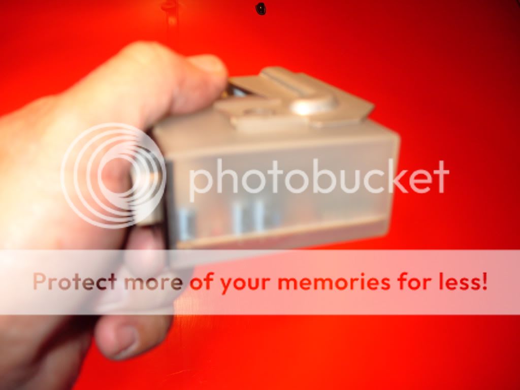

Not looking good took the panels of the rear hatch and found this plastic box with a printed circuit inside but looking at the diagram I now think its the electric arial timer so still looking for the amp.
Edited by Gaz 300
Hmm. The manual pic isn't clear but it does seem to show something like that in the tailgate "power antenna timer". The "radio rear amplifier" is in a different place next to the ABS Actuator. Don't know where, sorry. But it looks as if it might be to the right of the boot rather than in the tailgate. I wonder if RHD layout is mirror image? I'll drop someone I know an email.

  3. perhaps it wasn't fitted OEM? Do you have the pair of wires in the 6way connector on the harness. It's the one where the 4 rear speakers are driven from. If the harness connector has 4 wires (2 for each rear speaker) plus a gray earth and green/silver stripe, then these two are for the rear amp. If that harness only has 4 wires, then a rear amp wasn 't fitted - that's my guess, anyway.
