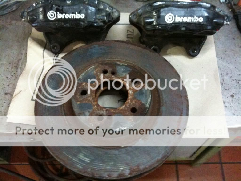

Heres a pic of the brakes I got:
The brake discs were free from wear but were badly pitted & corroded!

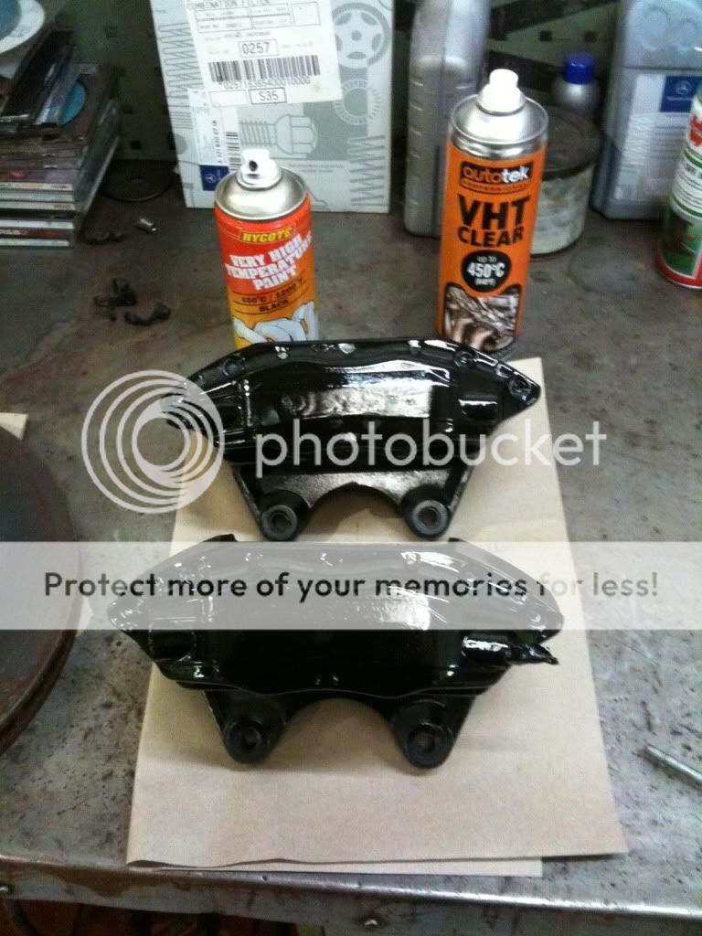

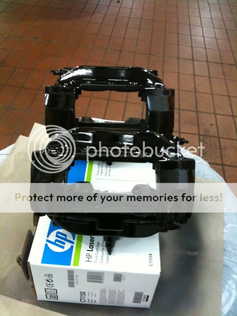

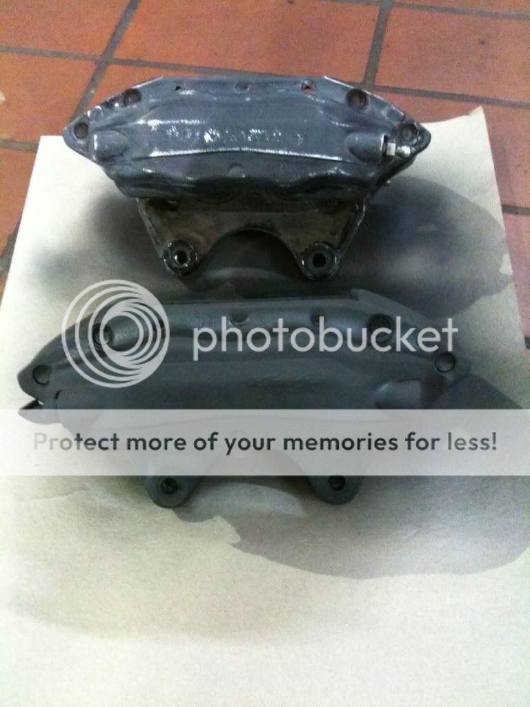

The calipers were pretty flakey with the lacquer peeling off & looked a bit tatty - I made sure the pistons were all nice & free (they were!) & removed & cleaned the bleed nipples. Then flatted them off for painting with some high temp paint & lacquer.
Heres one flatted off & one in base coat:
And a couple of pics finished with the lacquer on:

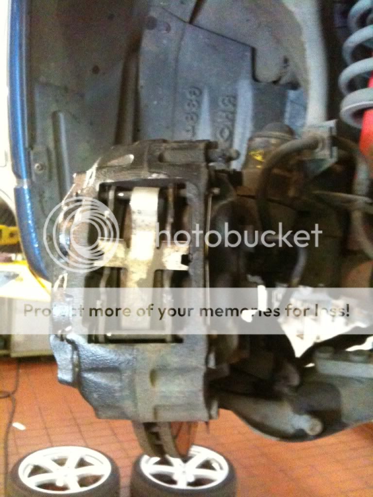

To do the swap remove the caliper by unbolting the 2 rear caliper bolts & remove the short steel pipe connecting the brake hose to the caliper as in this picture:

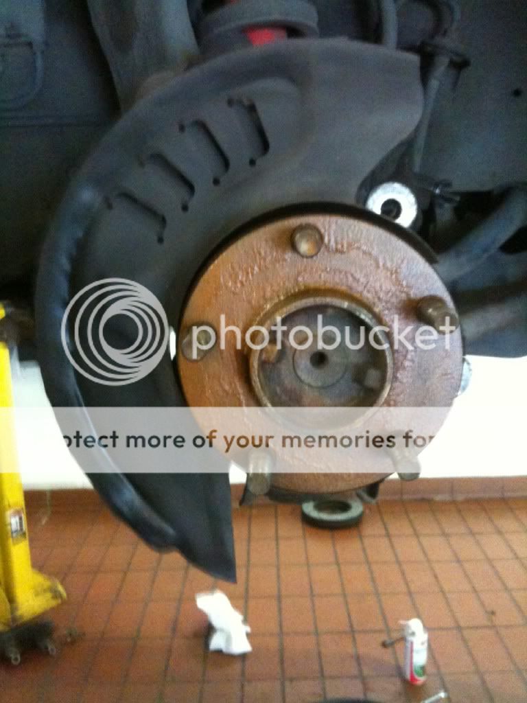

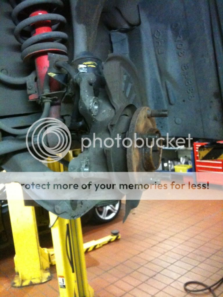

This will leave you with the hub like this:
Note that although the R33 calipers use the same M12 bolt size to hold the calipers on the thread is finer on the Z32 so make sure you get the R33 bolts if doing this upgrade!
The backplate needs a little reshaping to clear the new larger 324mm disc:

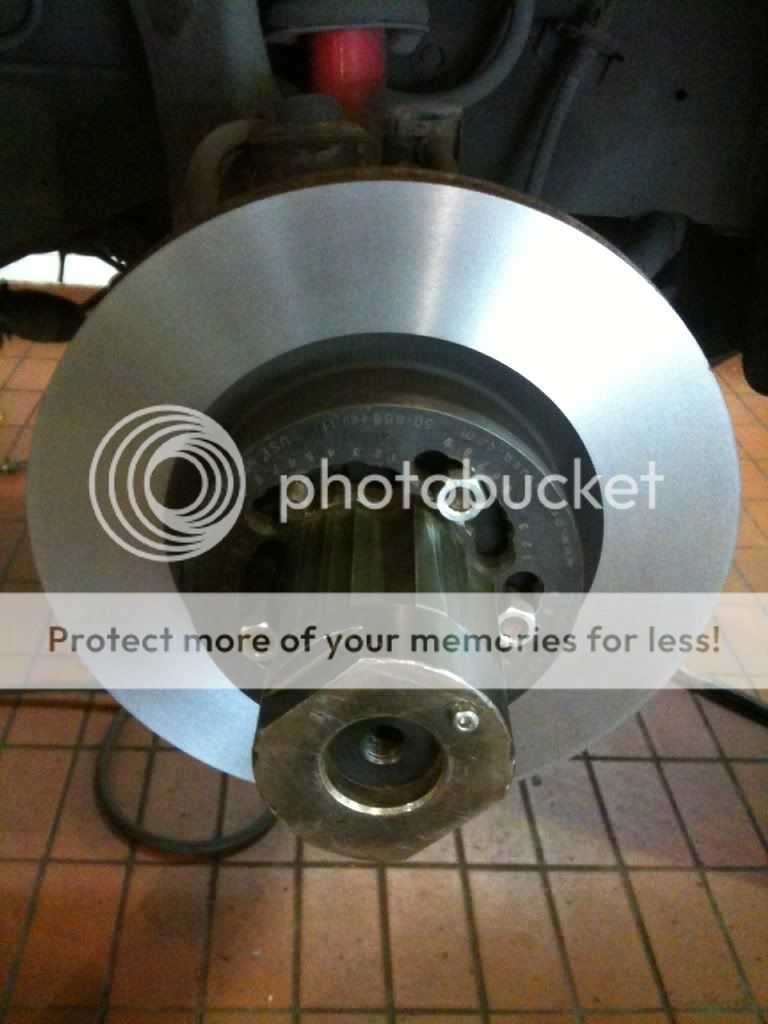

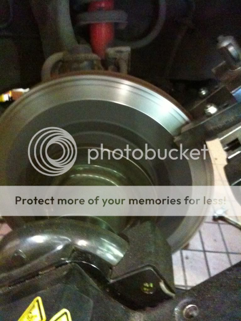

OK - all prepped & on with the R33 disc - as you saw this was pretty corroded, luckily I have a brake skimming lathe at work so made good use of this! I had painted the centre of the disc & heres a picture halfway through the manual cut:
And heres how it comes out after the skim:

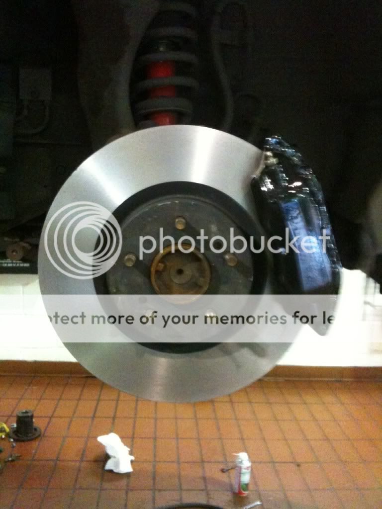

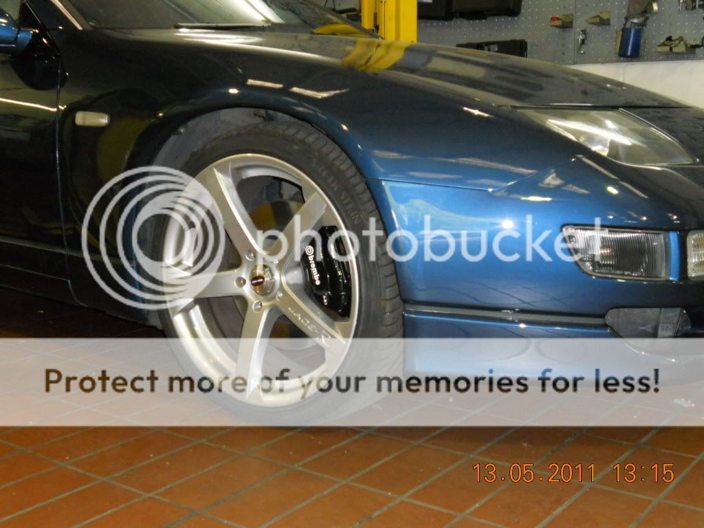

Now with the caliper bolted up - the small brake pipe does not line up so if in good order you can reshape this - if corroded badly then make up & fit a new pipe:

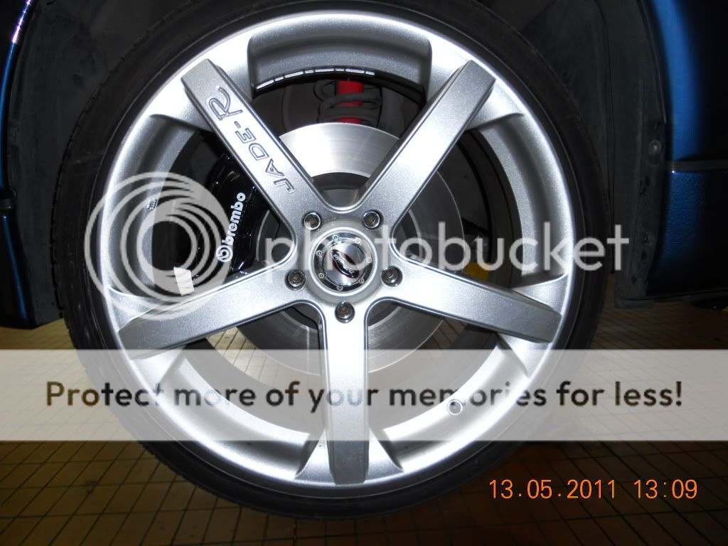

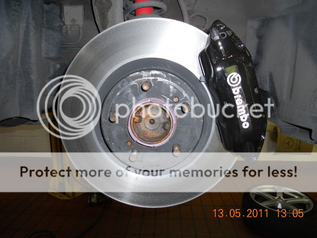

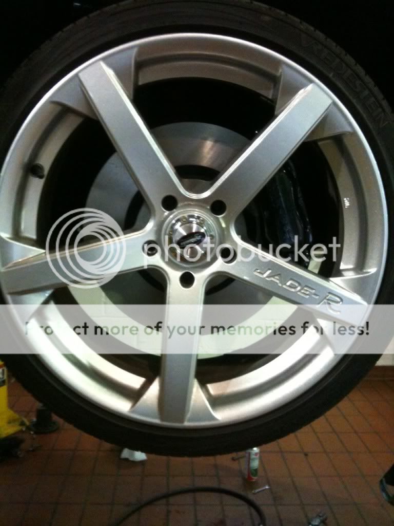

Finally with the wheel on:
I have some Brembo caliper stickers coming soon so will post final pics once these are fitted! :w00t:
Braking performance is hugely improved although I did have some sticking pistons on my old calipers.
Great upgrade for the price I paid (£300 for the calipers & around £30 for some OE pads).

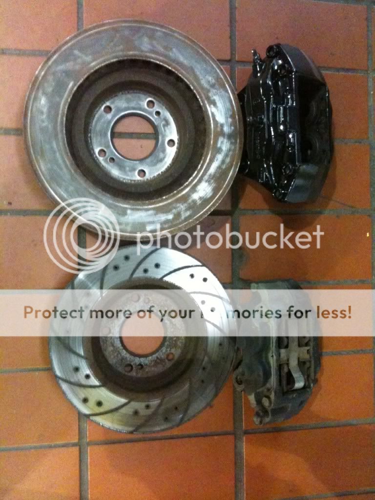

Another quick pic I took showing the difference in size between the Z32 calipers & discs & the GTR ones:
