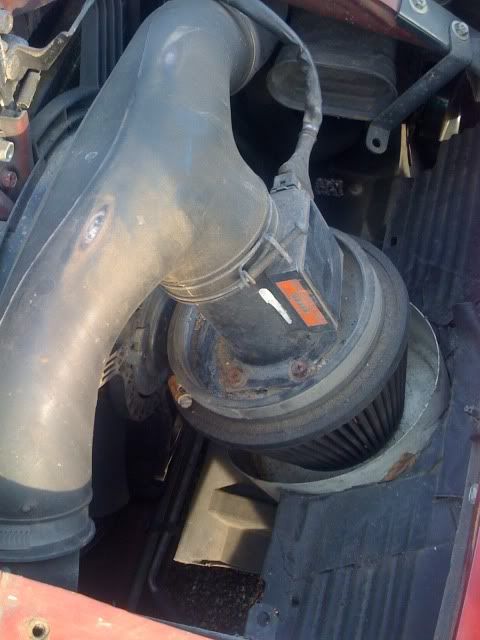

Im guessing this may be MAF but wanted some advice, I have added a couple of pics of an after market filter which has been on the car for years.
Should I try to get a standard airbox back on the car? no other mods other than exhaust.

i guessing to stop water getting at the maf but very odd way of doing it lol. il have a stab as no one else has, i recon ou may have a feul leak that isnt allowing full feul pressure to get to the injectors and its leaking out premeaturly. lean mixure, poor running feul smell. with the engine cold get the bonnet opne and fire her up then check all teh fuel lines including teh one under the throttle cover.
I cant believe there is a biscuit tin round the base of the filter.. its a nightmare waiting to happen when it rains..

No idea about the tub around the filter?

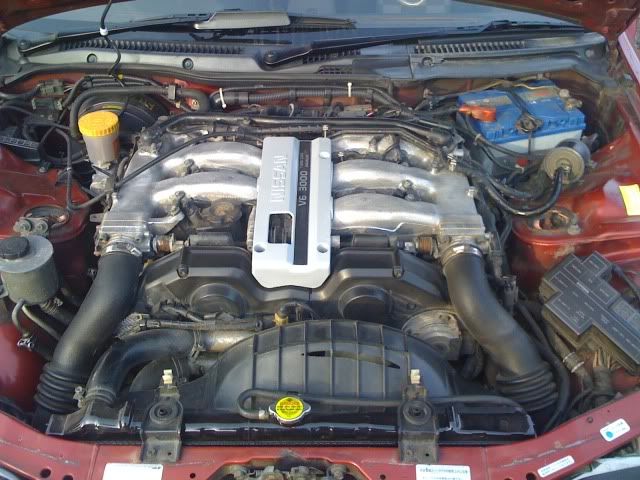

Where is the PTU located and what does it do? Is there a fix or straight relplace?

yeah sounds like the ptu, i had the same thing a while back and switched to a series2 ptu, its shown in the pic the metalic box with fins on, hope it helps.

I read in a cone filter guide (http://s95014253.onlinehome.us/63104/80397.html), that after fitting; air can enter the cone into the MAF with weird turbulence, causing the MAF to read the airflow incorrectly causing running problems. It was suggested that deflecting the air away from the bottom of the cone would cure the problem. I think this biscuit tin lid is for that purpose, though doesn't need to be a cup shape which can hold water.
Drill a drain hold in it I guess....

Its actually the bottom of a bucket I noticed today (not that it makes a great deal of differance) the are drain holes in it though.
