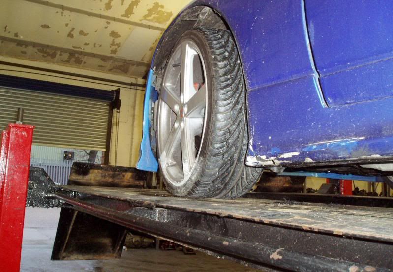

Bad luck befell a zed owner today, travelling to us for an MOT a mistake, slippy road surface or both and seconds later one zed sitting odd on the passenger side and the n/s front wheel buried hard into the kerb.
A recovery truck ride to the workshop (nice truck) and we soon had it on the four poster.

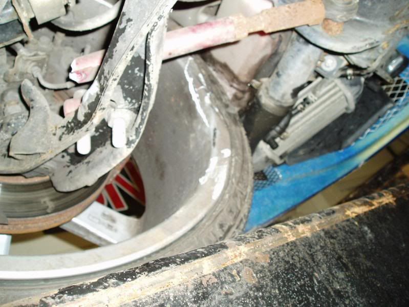

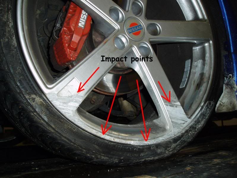

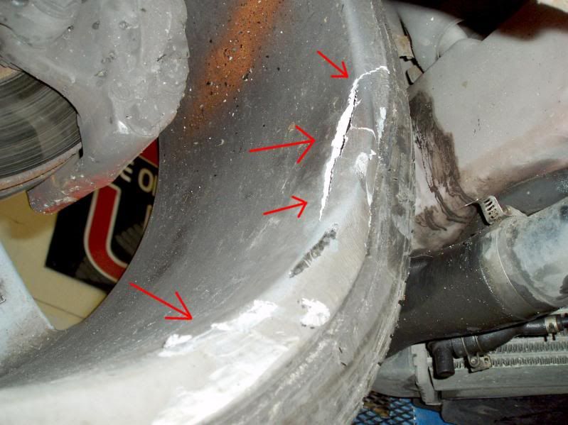

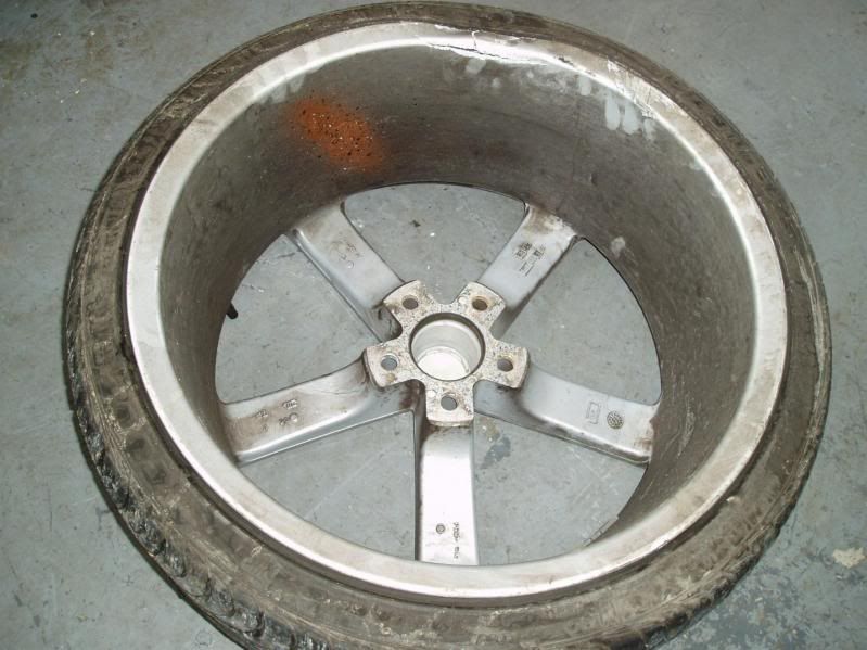

The wheel looks particlar sorry for itself, in the flesh as it were it looks horrid the alloy has been eaten away by the kerb, if that did not look bad enough the inner side of the wheel is worse! still can not work out how the tyre has any air in it?

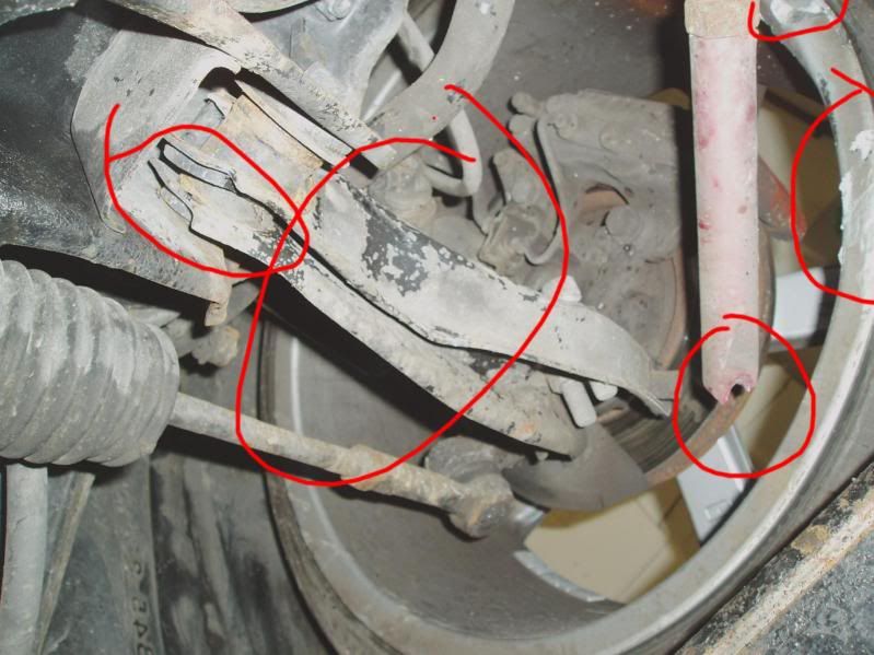

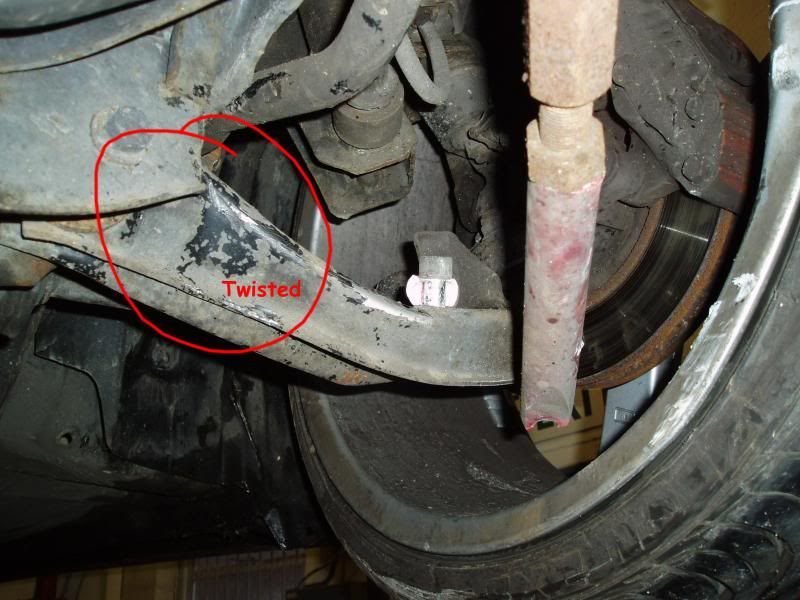

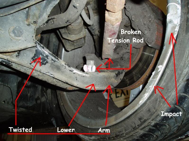

As your look more the damage just goes on, the lower arm having been severly twisted and the adjustable tension rod arm has snapped clean through.

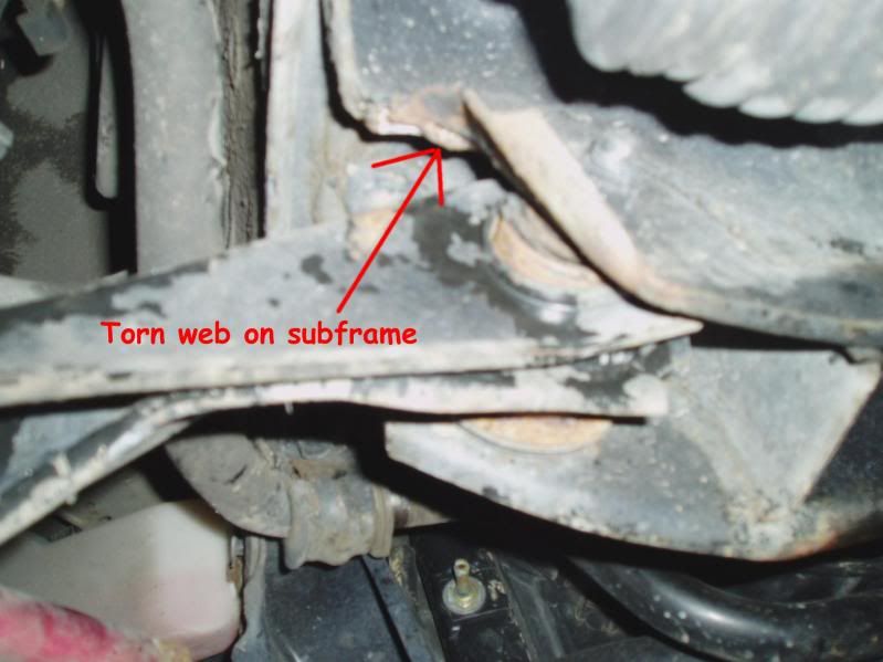

The lower arm has been pushed so hard back its has torn the web of the subframe where the lower arm is bolted up to it!
Multiple damage sites, the lower arm, the tension rod arm, the antiroll bar bracket, the wheel etc.

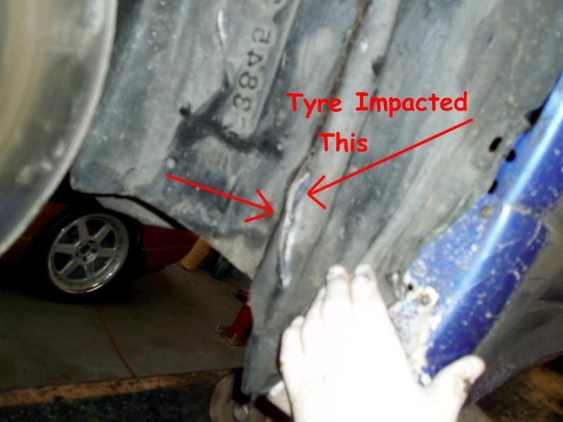

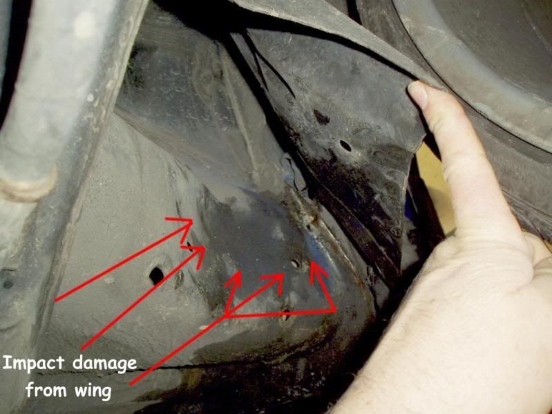

The wheel had been pushed back much further than first thought as can be seen by moving the rear wheel arch liner back to reveal damage to the lower bulhead.

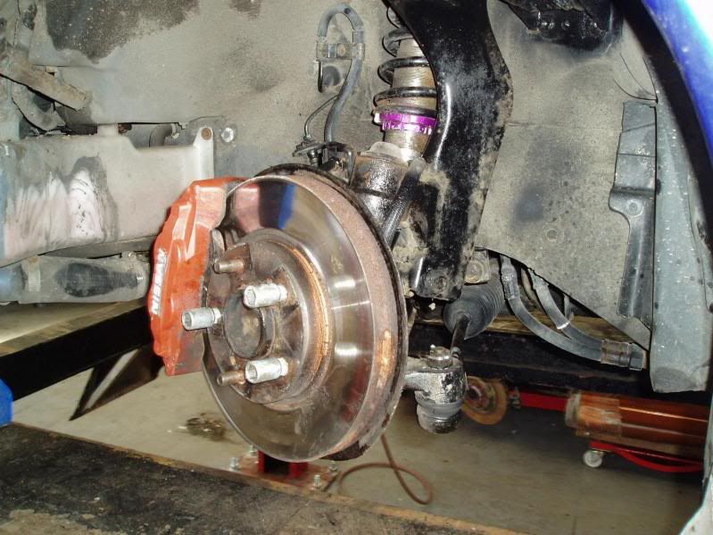

Updated pictures of the repair, the wheel looks real nasty on the inside edge and the tyre has been cut quite badly down the tread pattern.

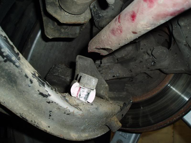

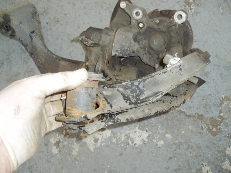

With the wheel off you the lower arm damage is more visible, the drop link was bent as well as the sheered tension rod arm.

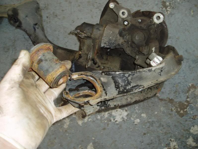

The lower arm bush were it locates into the sub frame had literally been torn out and was just about holding on, if this had failed the wheel would have tucked up under the car possibly causing even more damage.

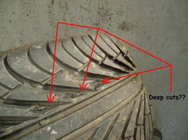

Even the tyre had not come out undamaged, along a section of the thread pattern a deep cut ran through it, looking back to the rear part of the wheel arch the liner had a slit in it, when looking behind the line all becomes clear, there is a body seam that protrudes forward and this had done the damage to the tyre.

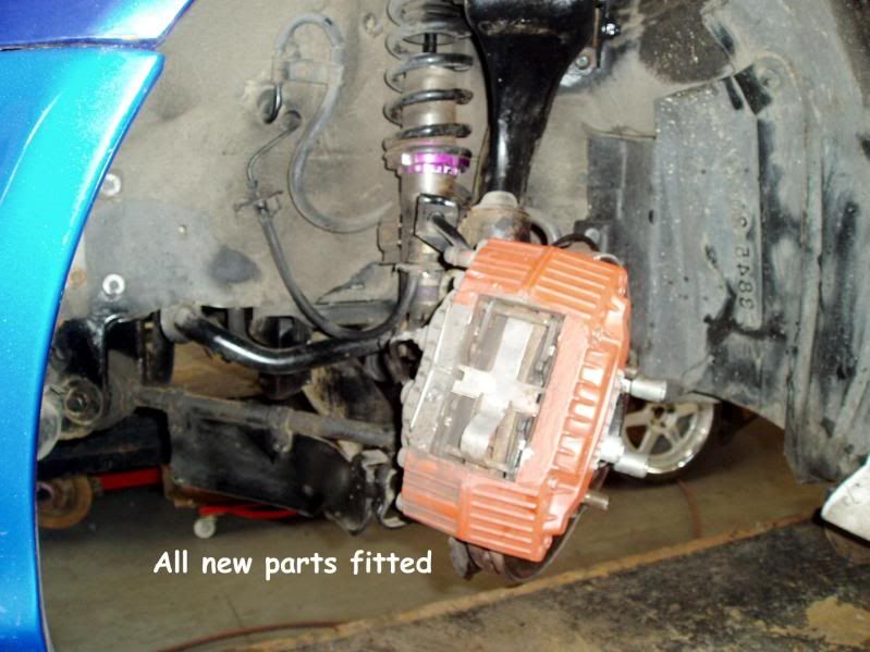

With all damaged parts removed a few repairs to the sub frame were required, luckily the damage turned out to be less than originally thought.
So on with all the new parts, alignment and new wheels and all was good, a road test proved all was back to normal and today it went straight through the MOT after we had changed the very worn hicas arms.
Now the hicas arms may well of contributed to the unstable road holding on the day the accident happened, worth checking these things, jack up the rear wheels enough to be just clear of the floor and hold the wheel at the quarter to three position and shake left and right, there should be NO movement if there is, then check at the half past six position if there is movement there also its likely to be the wheel bearing, however the most common issue is the hicas arms or the outer hub bushes, not overly expensive but make a world of difference to the handling.
