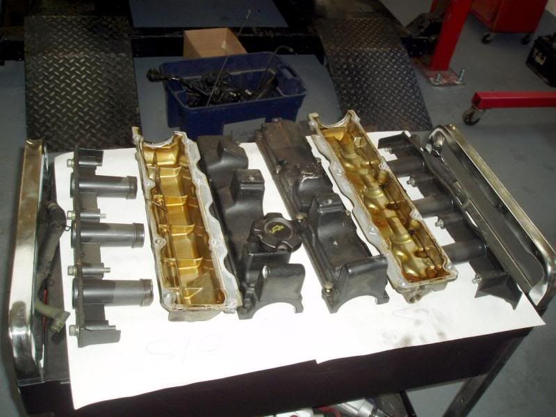

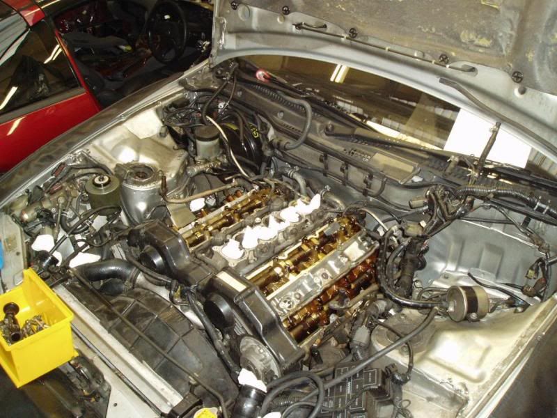

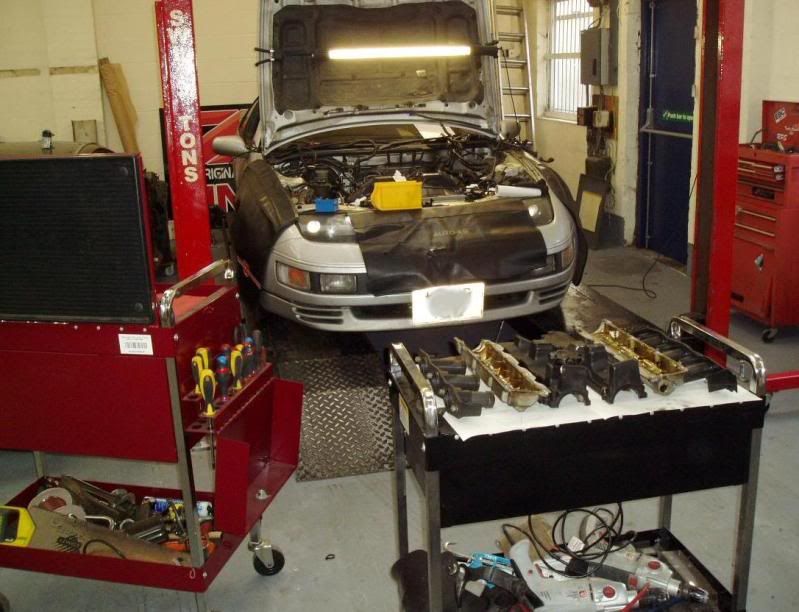

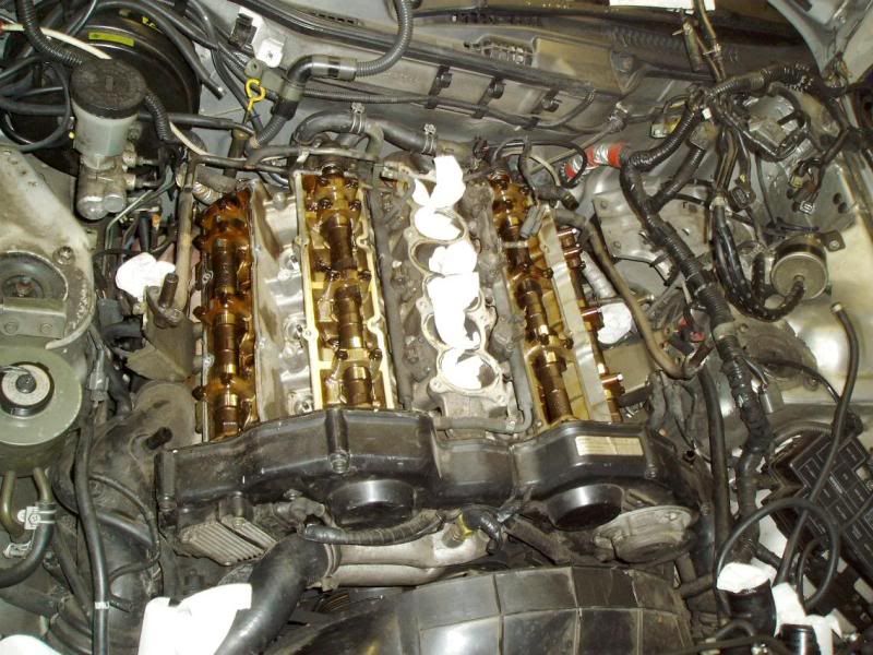

So stripping out the relevant parts to get to the pesky covers and re-seal them is fairly straight forward but its is essential to be clean and safe, keep all parts in order and cover all intake holes whilst the plenum is off so nothing can drop in there.
The two inner covers have quite chunky rubber seals and new ones of these are readily available from Nissan ( do not use e-bay ones)
However for those who do not know the outer covers do not have seals but sit on a bed of sealant, this can be a bit tricky to get right if its your first time doing this job, but even before you even start that ensure all traces of the old sealant are removed and non of it has fallen into the camshaft area, a wipe with brake cleaner or similar to degrease the faces is vital or the sealant will not have a chance. just remember to be CLEAN, CLEAN, CLEAN!
Despite Nissan having a specific sealant for this job, high temp silicon sealant is more than capable and works out just fine, so with a bit of care and time you can enjoy the thrill without the pong!!
