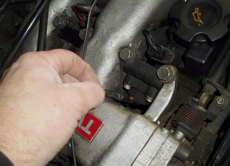

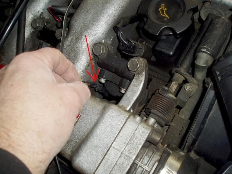

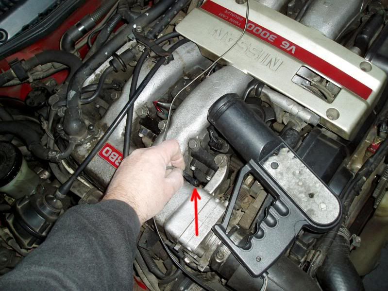

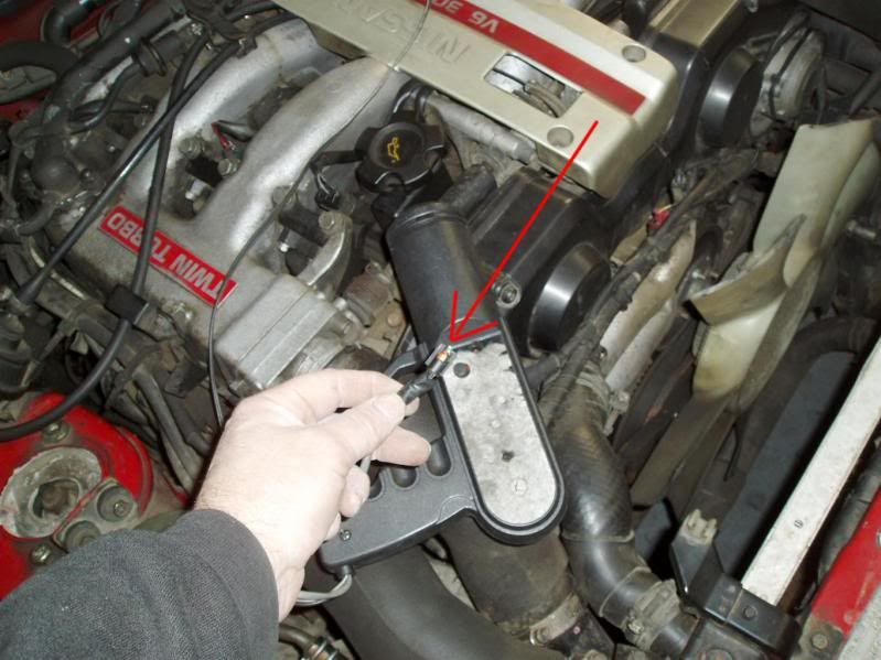

Ok quick tip to save buying another timing gun, the induction one you have should be capable of sensing the coil packs triggering, if the head of the clamp is small enough place it down the back of no1 spark plug and it should work just fine , if however the clamp head is quite large then they normally are screwed together, undo the screws and your left with the induction sensor on the end of the cable, this is now easy to place down the back of no1 coil pack, assuming all working with engine up to temp then 15btdc is what you need to set it at.( will post a photo of this if it helps tomorrow)

Ok here is the pictures for for you, the first shows the timing gun and the sensor from the trigger clamp.
In the second one you can see where the sensor need to be placed, in pic three shows the sensor in a slightly different place, it my be trial and error on where best it picks up the signal, seems quite ok almost anywhere near the coil windings, pic four shows how it looks from further back.

JeffTT, Many Thanks for going to the trouble to post pictures, Worked a treat. I owe you a pint or 3. :flowers:
