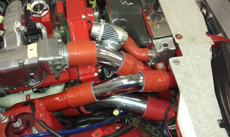

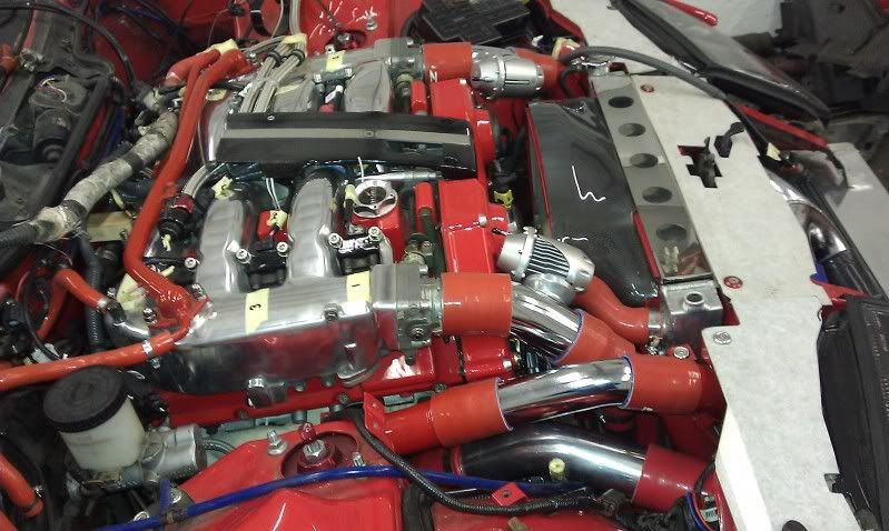

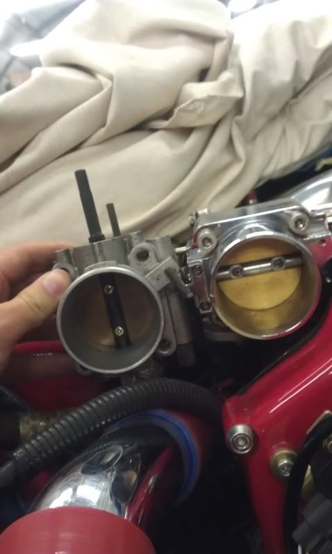

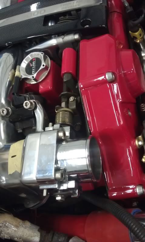

Fitted enlarged Z1 throttle bodies. Had to port the plenum to match the bigger butterfly and fiddle with the linkage to get them to work.
Custom made 65mm dia turbo inlet pipes either side as the stock pipe was the wrong shape and alot smaller dia.

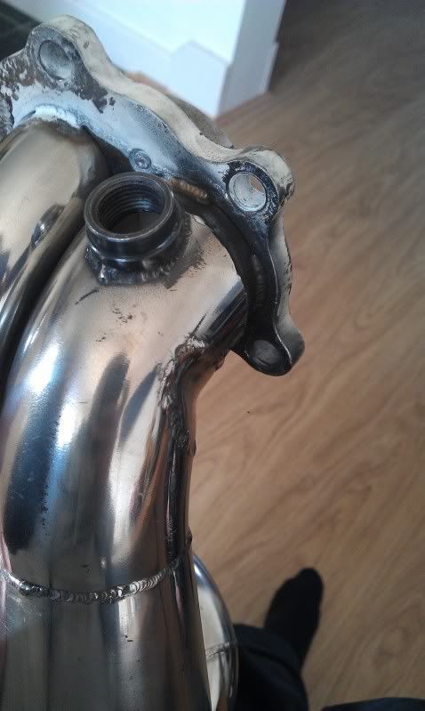

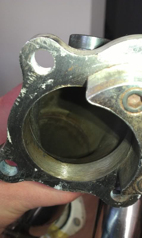

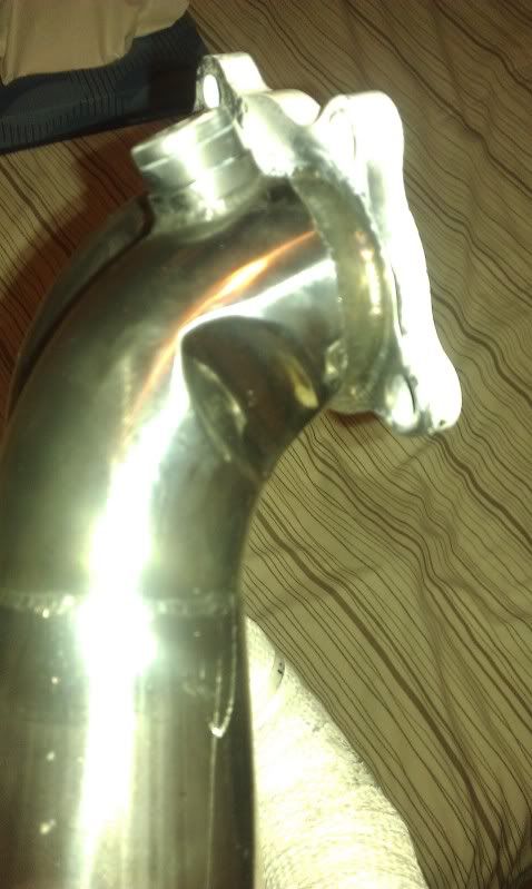

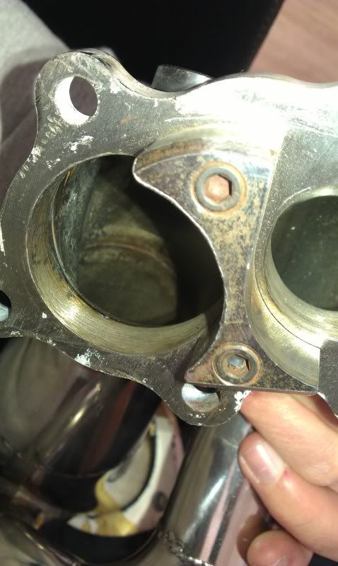

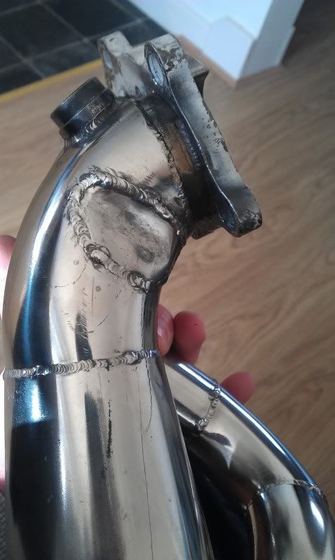

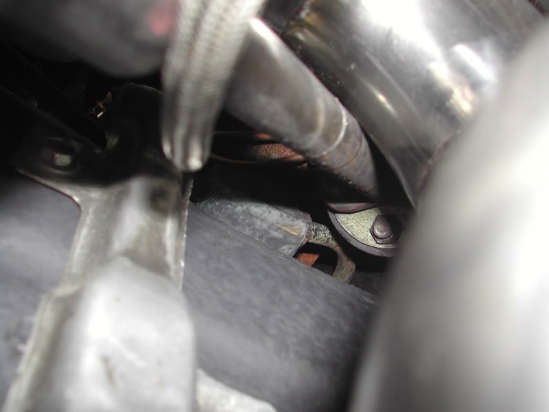

Quite alot of messing about with this down pipe has had to be done to get it right. Pulling the engine in and out countless times was never fun.
This is the result 2nd time round. The pipe had to be adapted so it didnt touch the steering coloum (as pic) Hopefully this is the last time and alot less restrictive than the first attempt.
First attempt was way to restrictive.
Latest.

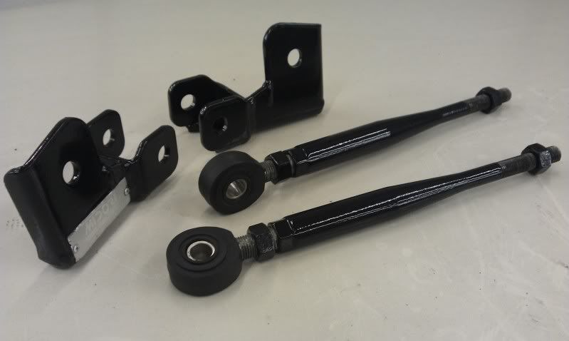

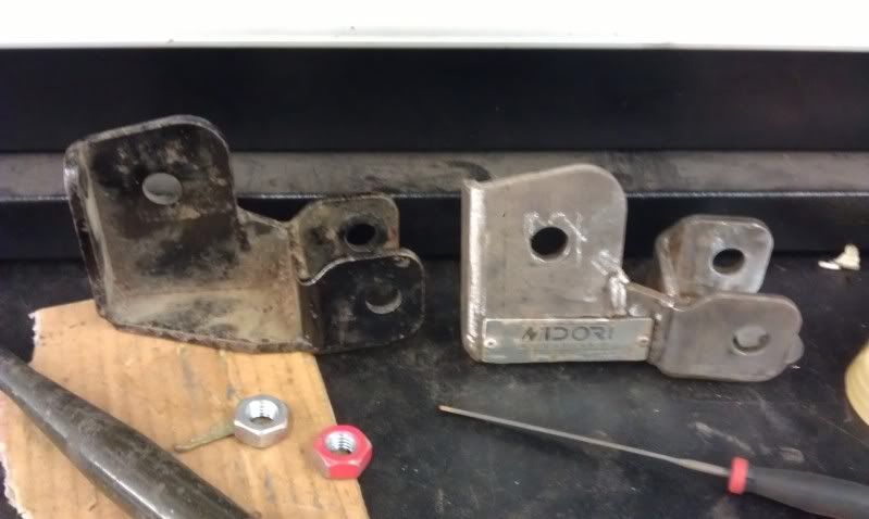

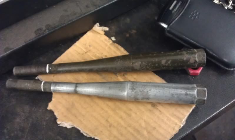

One of many Hicas lockout systems ive bought lol. This one is by far the best out of them all SPL are expensive but hope its worth it.

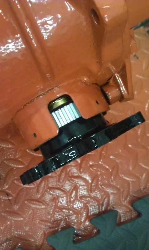

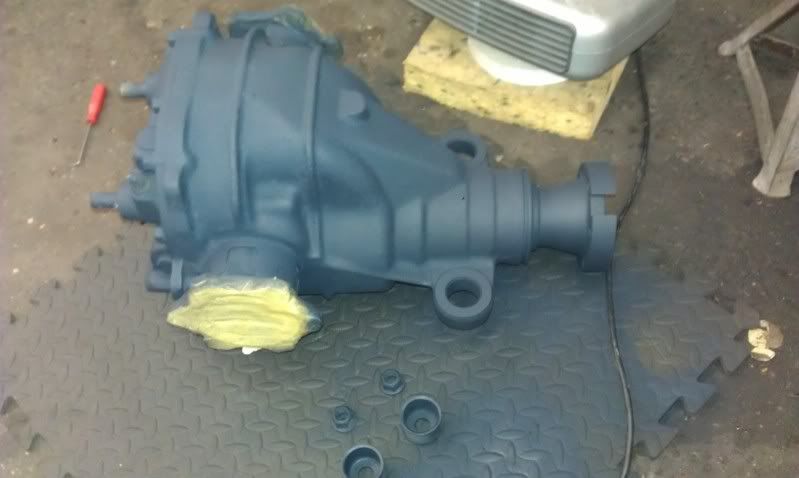

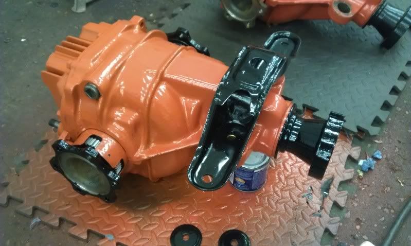

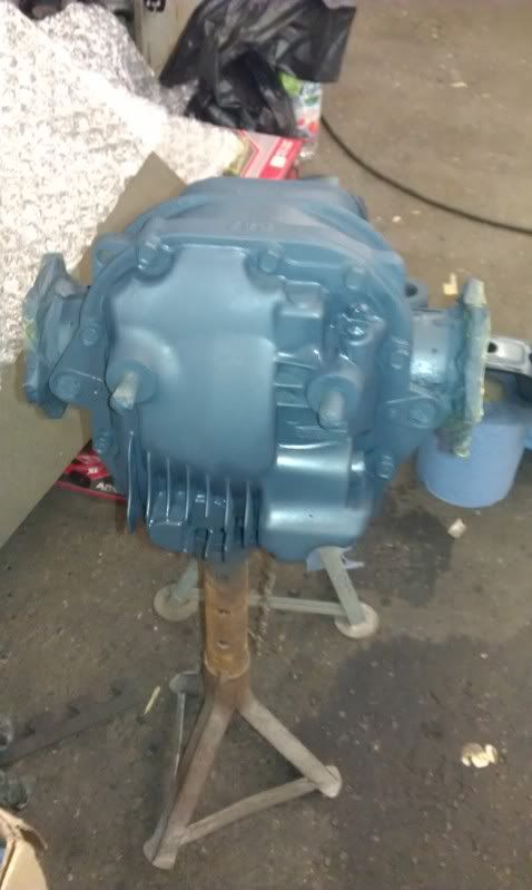

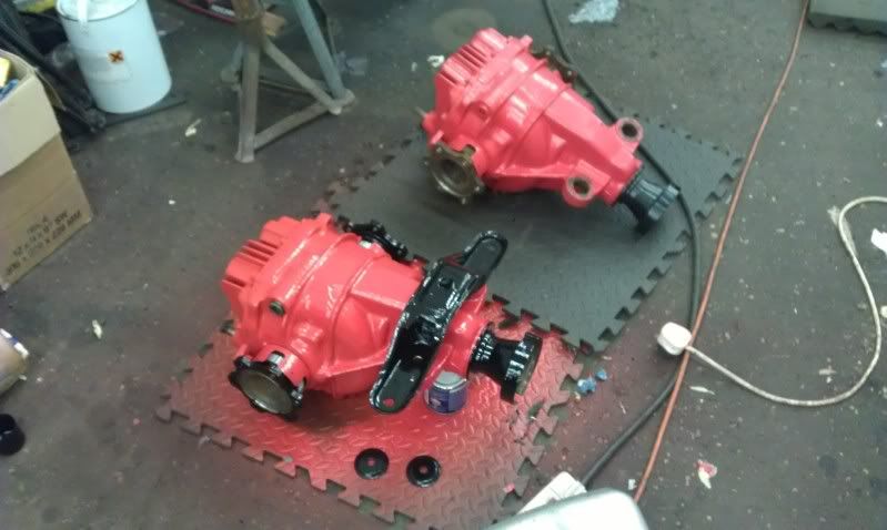

I had the stock viscous diff binned and rebuilt with a Quaife ATB diff new crown and pinion etc also fitted with 3.10 ratio leader gears instead of stock 3.69 ratio.
Painted to match the rest of the running gear..

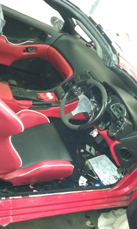

Seat fitted too but the interior is not 100% finished yet ill update you when the new parts arrive.

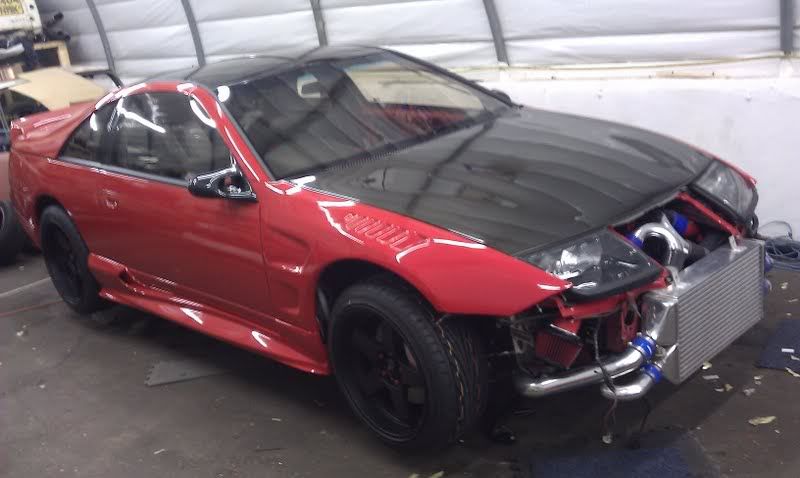

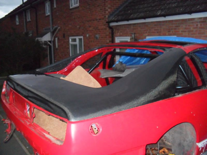

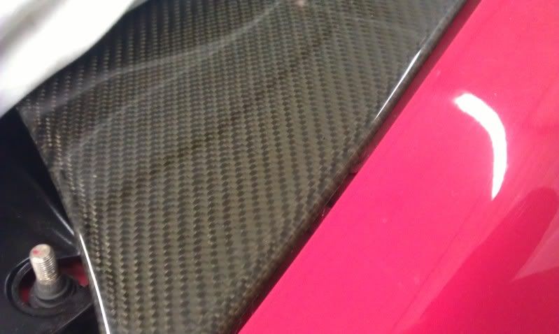

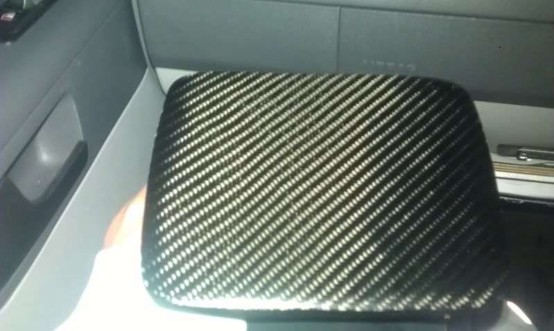

Some more Carbon.. Saving quite abit of weight off the standard hatch. Just got to get round to fitting the hatch and window.
not my car..
Also the guy i bought the hatch from was nice enough to give me a custom made carbon petrol flap.
Top guy :D

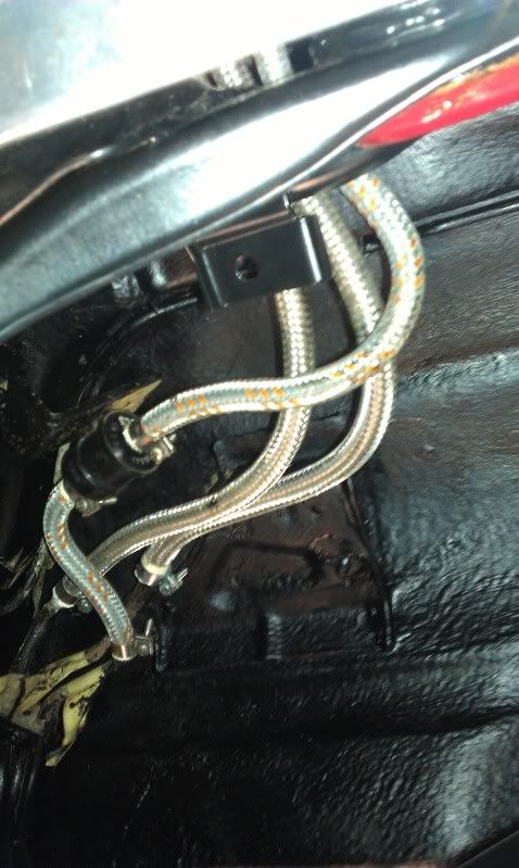

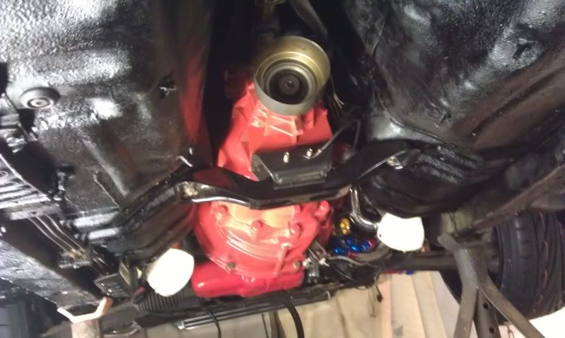

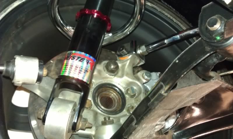

A few random pics of the suspension and fuel lines under the car.
Edited by GIBSTER-TT

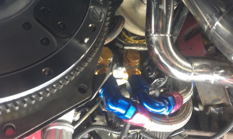

can i ask where did u route and mount the pipes and oil cooler ..
as i'm just doing mine now ?
I ran them down the drivers side of the engine. Cable tied them together and fixed the to the chassis rail. Its tight but the pipes are rigid and wont be moving anywhere.
The cooler i made a custom mount that sits between the rad and FMIC thats the only space possible for my build. I will be running ducting in to the location as well
all most the same as me then
i routed pipes from adapter over the subframe/steering rack just under the alt and mounted the filter on
the side between sub frame and anti-r bar .. then through the front between rad/pipes
the only problem i have is to much pipe

I bet that CF hatch set you back a fair bit LOL.
