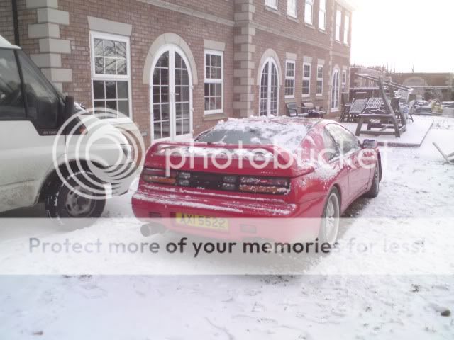

Get the car from the back of the house to the front. In the snow!
Hooked the van up to a bit of rope, and pulled it round (slipping and sliding!)

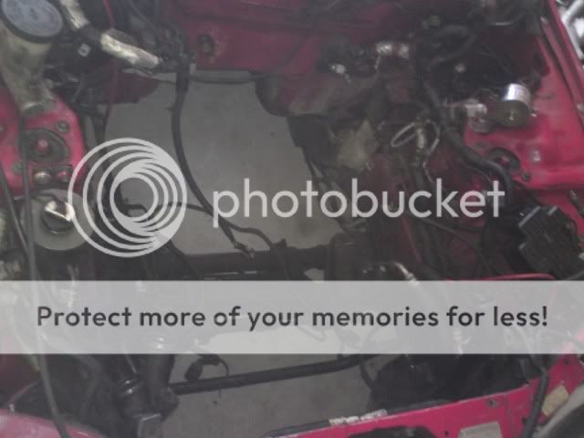

Start stripping

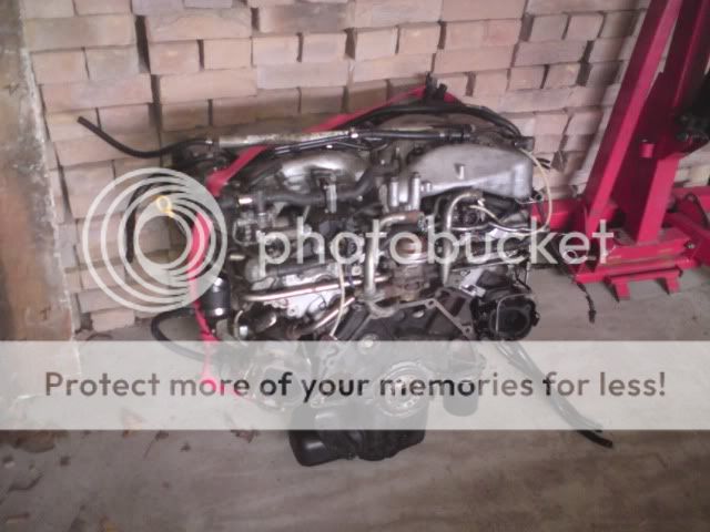

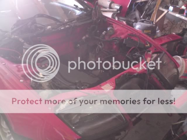

The new engine..

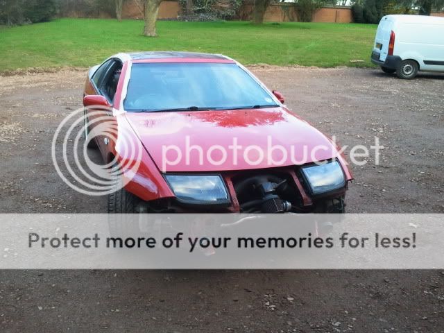

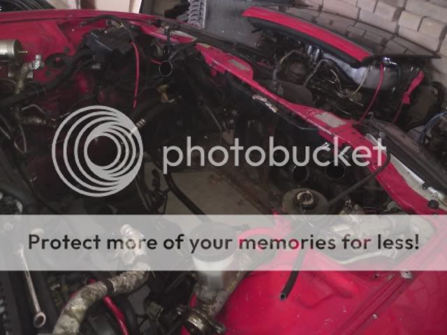

Hours later, front bumper and everyting off to get the hoist closer...
What a job!!!
Ended up taking the hole exhaust off, prop, gearbox, rad, everything. Is there an easier way??
To my horror, i found it had NO air filter, no even an air box, maybe why it blew up!
Thats how it is now.

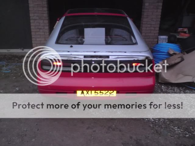

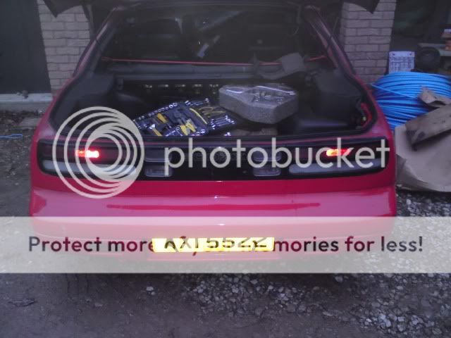

And the lights....
I think it makes quite a difference to be honest, glad i bought them..
Thats it for now, hopefully i'll be updating soon with a picture of it with an engine in it!!

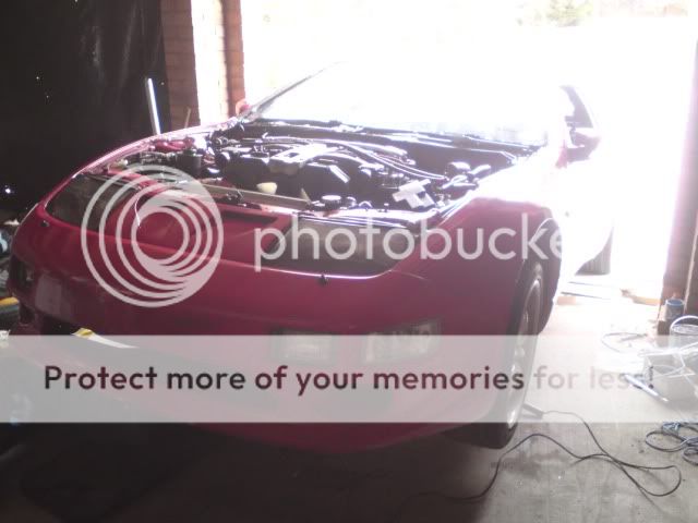

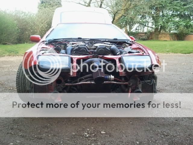

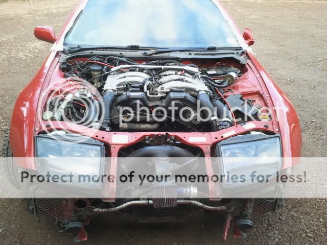

ENIGINE IS BACK IN!!
Pictures to follow, but the engine box and prop are back in.
Took 2 hours just to change the turbos with the engine off the car.
Needs another days labour to get it on the road, but its closer now!

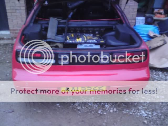

Only 1 picture.. I thought i took a few.
Oh well, here it is.....

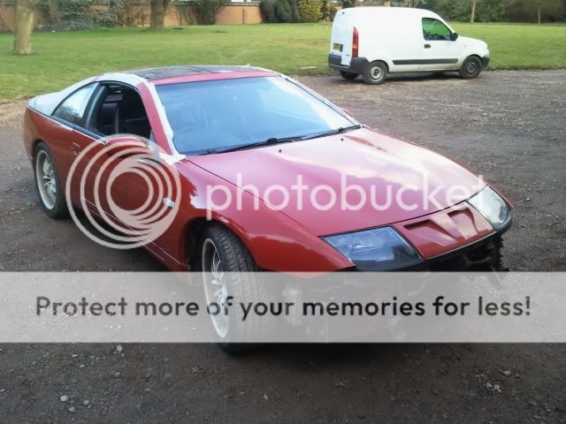

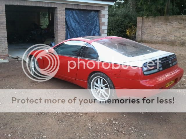

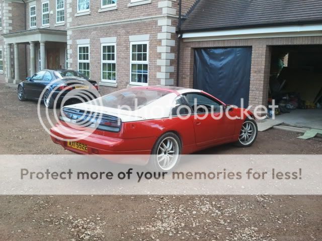

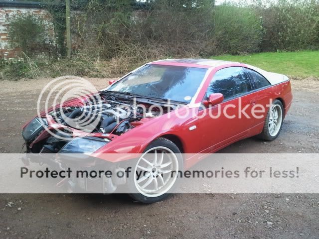

It was out of the garage today, and i hadn't seen it properly for months.
Forgot how good it looked!
I need a roadworth Zed asap!!
M3 is for sale, as is the Mr2.
The zed is enough for me!

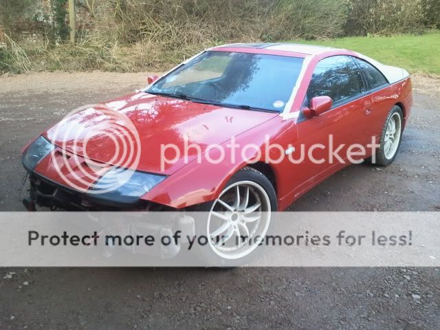

Zed may be at the end of its road..:cry:

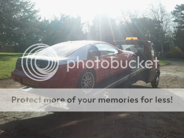

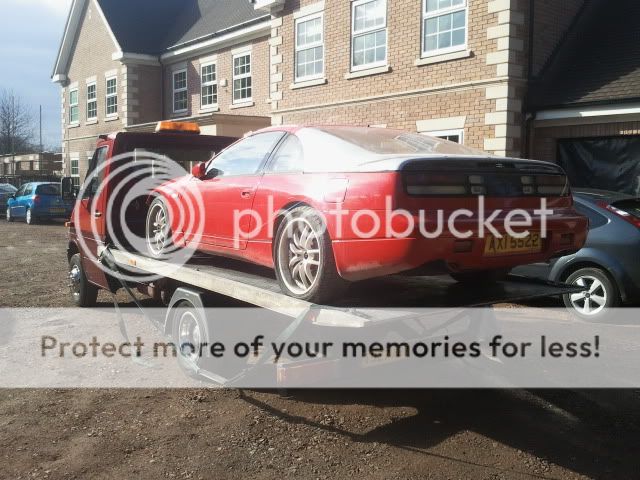

Not really an update, but i got it out of the garage today as its going to Zedworld tomorrow to hopefully get fixed!
The sun was (half) out, and i'd forgot how good a looking car it is, even tho im not a fan of red!
Zedworld bound..
This morning, on the truck on the way to Zedworld.
