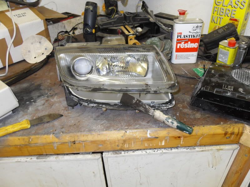

I,m getting some duct vent off CarMad so i,ve had to relocate my sidelights and thought i,d do the angel eye mod .

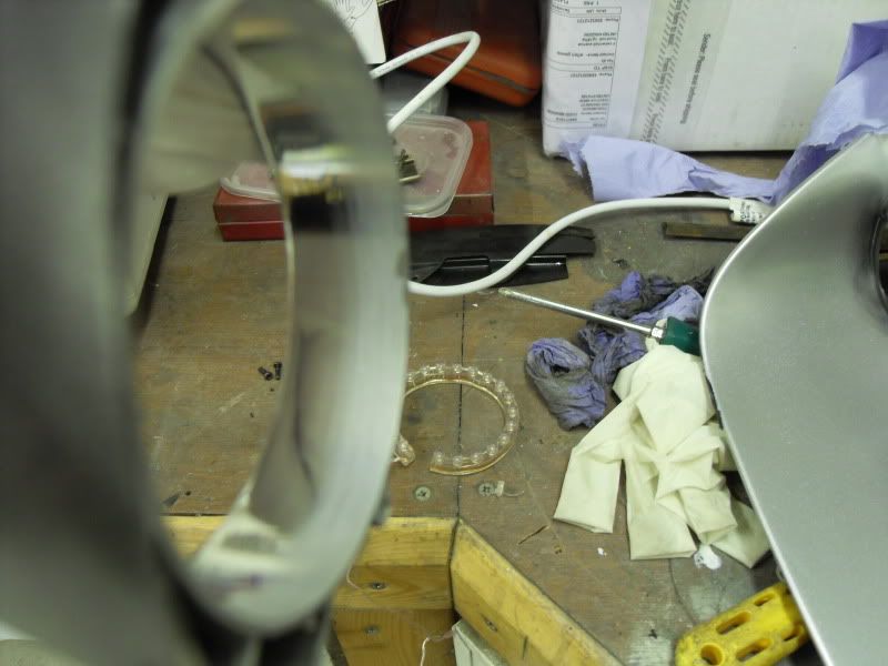

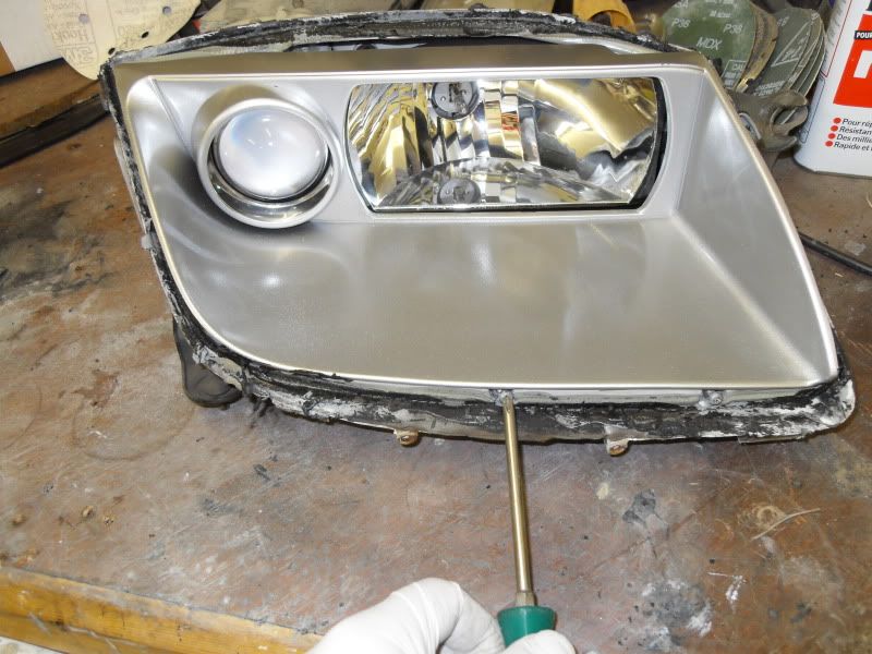

Remove the metal plates and the rubber around the light , warm the glass well and using a flat scraper gently prise the glass up and off the headlight

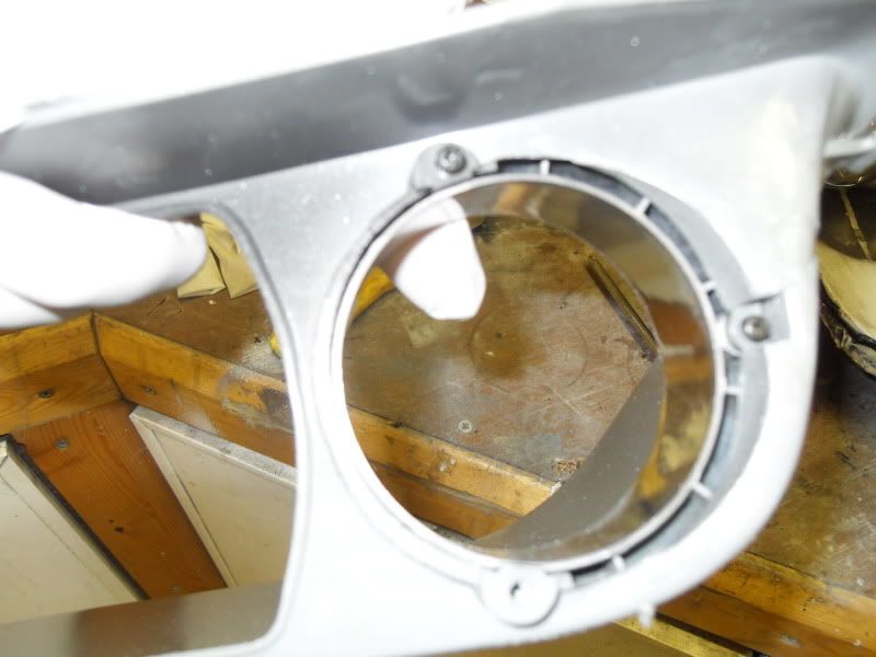

Remove the 2 screws from the bezel and lift out .
The reflector area is held on with 3 screws , take this off so it,s easy to work on .

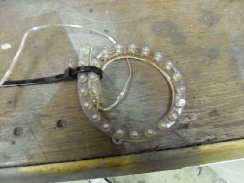

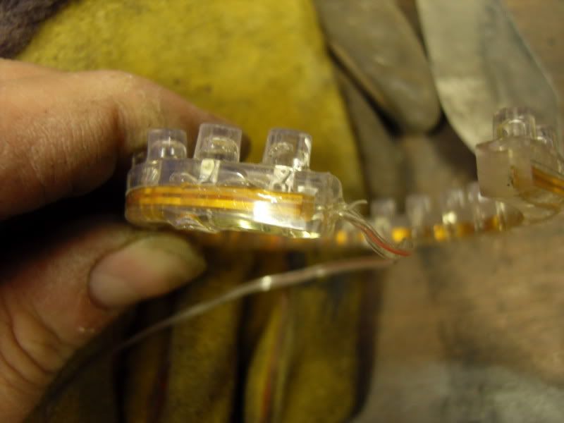

The led strips have 24 leds in them but can be cut down after every 3rd led and still work , cut back as close as possible to the 4th one and you,ll find they go in the reflector but i found thy were still tight not sitting well , at the other end where the wires come out there,s a little bit of material that can be removed CAREFULLY so you don,t cut the wire , this allows it to sit flush without trying to lift.
I used some scotchbright to key the chrome , got the leds sitting evenly with the join at the top and wicked a bit of superglue around it .
Btw i had previously coiled the strips , warmed them and let them cool , they hold their shape alot better.

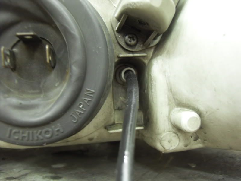

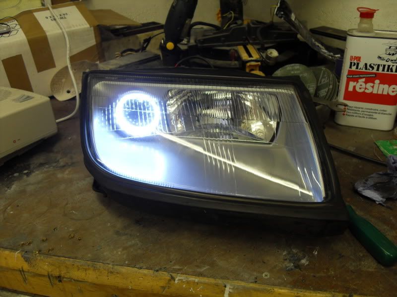

I put it back together making sure it all worked first, i soldered a stronger wire to the leds and ran it out of a breather at the back of the light

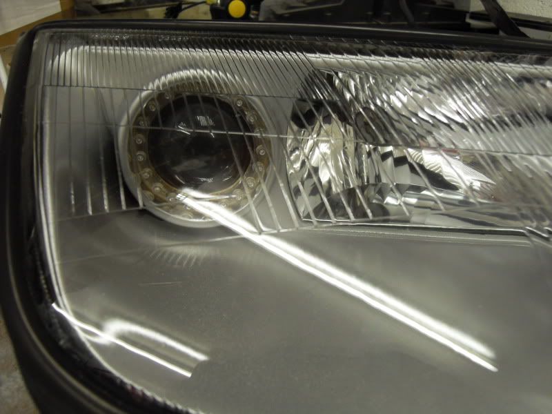

And the finished result but don,t forget to clean the insides well before rebuilding.
Some good work, they look nice and bright :wink:
C'mon get them fitted and take a head on piccy at night and one in the daytime :yes:

do they not get too hot when the dipped beam is on ?? i woud imagine that the rubber material incasing the angel eyes would start to melt as that domed projector lens gets stinking hot
The hid,s in mine are what i canabalised out of a pair of merc headlights a good few years ago before these plug and play kits were available and i used the merc bulb holder for which i used epoxy to glue it in place and thats never come adrift so i cant imagine having any probs as these are a good few inches away from the actual heat source .

Took a couple of hours on the first one , i used two 2kw fan heaters blowing on either side of the headlight to warm it up nicely, you can see them in the first pic .
You could use a hot air paint stripper as long as your gentle to start off with. HTH
I did similar to this last year and the led strip does not seem to be UV stable and has turned quite yellow - so keep an eye on that sir.

Put the oven on at around 100 degrees, this method warms the gunk equally, keep popping them in for 10 min stints and then more prising, once you get a corner out and it's nice and warm it comes apart a treat :thumbup1:

I done this on my white zed about a year ago... They go yellow after a few months I'm afraid :(
