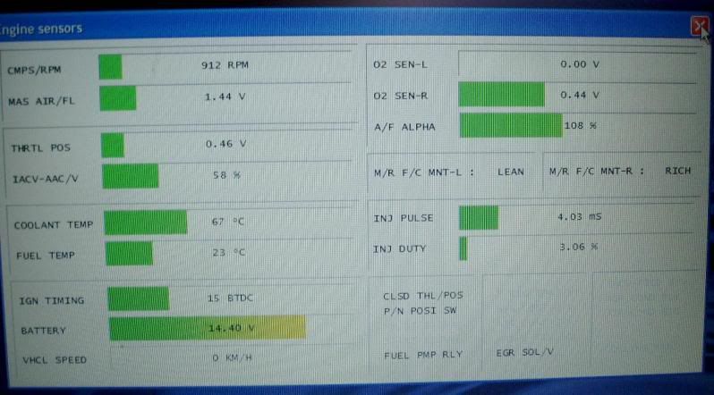

ConZult screen One
So here is the first screen shot, for the uninitiated the there is a fair bit of info on it that is important and some not to worry about but in short there is a faulty O2 sensor a good timing reading ( confirmed with a timing gun) a high iavc ( idle control ) valve reading but the temp is only 67C so again not to worry about yet, BUT take a look at the injection pulse 4.03 ms !!! this is practically double what it should be, but with a an A/F reading of 108 % it could be easy to miss it as excessive enrichment. High injection pulse can be cause by air leaks due to the readings at the air flow meter been corrupted by the leaks or and very common a failed afm can give poor or corrupted readings that are still in its total range so hence no fault code error readings.

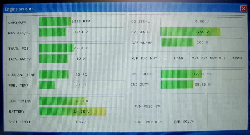

So trying to keep it brief the next screen shot is some time on, lots of things have been checked again and again including timing, air leaks , vacuum pipes, throttle balance tps o2 sensors disconnected and reconnected, spark plugs checked cambelt timing checked all with no improvement.
So this particular screen shot shows an amazingly odd set of readings if you look at the part throttle tps reading against the actual engine revs of 3,700, this again was a hard, slow and lethargic engine that was slow to pick up. The injection pulse of 12.5ms is worrying so was the awful smell coming from the exhaust serious incomplete combustion, luckily we have a very well ventilated workshop!!
A split second after this screen shot without any more throttle opening the engine revs to over 6k very suddenly, releasing the throttle the revs dropped to idle, each time we tried the it the same thing happened. Now this is all very odd but even more so when you consider that we had the air flow meter disconnected at this stage!!!! yes that's right an engine revving at 3,700 and upwards with the air flow meter disconnected.

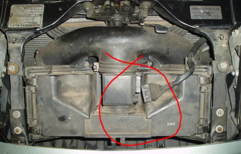

AFM Disconnected
So now we have moved up a gear with an engine that does not respond to the expected fault finding procedures as with the afm disconnected the engine should not rev pass 2,500rpm, oh and no fault code appeared in the ecu memory.
