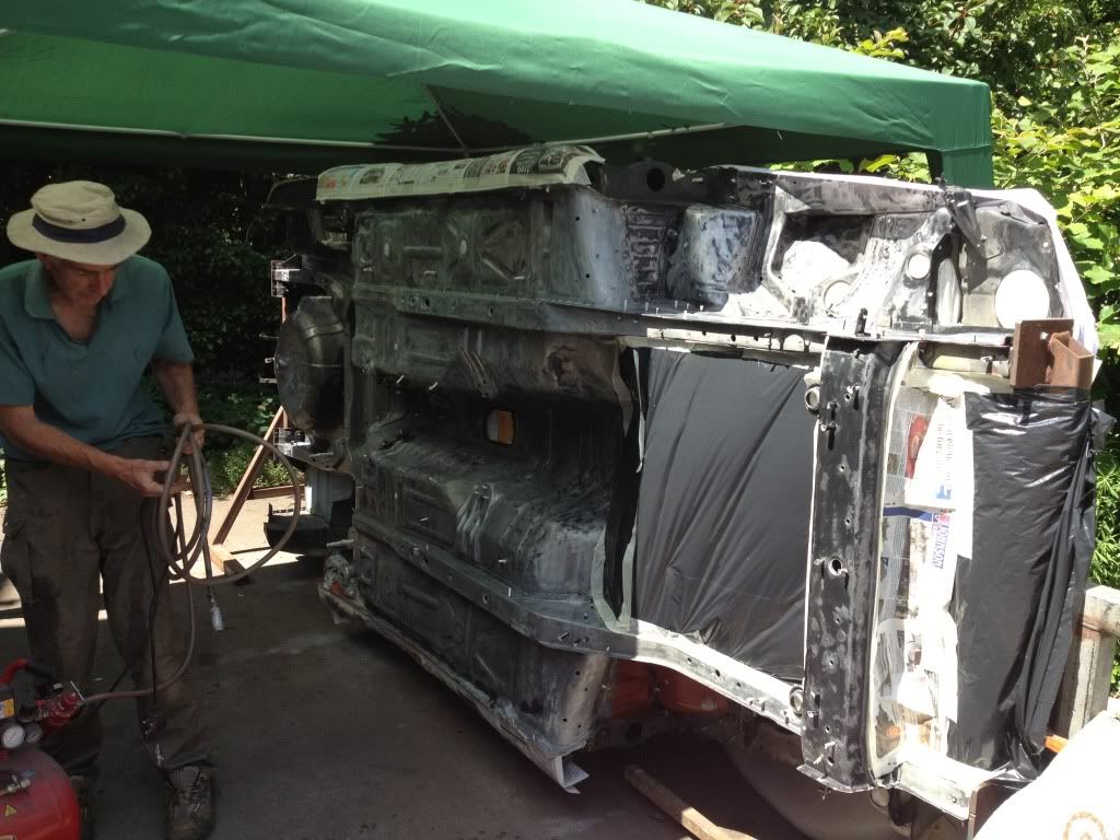

well loads has happend on the car in the last 6 months
im very happy to say all welding grinding and other similar crappy jobs have been done. The whole of the body has been taken back to bare metal and the floor pan etc has been restored to the best of my abilities
i cant add photos at the moment but will add them in tonight.
in a nutshell though.
both sills have been replaced with new panels as seen earlyer
dents in floor and chassis rails have been corrected
rear arches behind wheels have been rebuilt
engine bay has been shaved
rear hatch smoothed
aerial removed
stealth relocation of under bonnet crap, inc battery, hicas (gone), pas pot, fuel filter, fusebox etc
paint is now on the underside, this consisted of the following
bare metal cleaned, degreased and phosphate etched
2 coats of epoxy mastic
1 coat of etch
PE seam sealer
stone chip in arches
2 coats 2k in white
this little lot should last a long time plus looks amazing
body shell should hopefully be in topcoat this weekend, its a little different to when it was last seen as i have had a change of plan and now is ford frozen white with a black roof. I would have gone for a nice pearl but i know my limits when painting.
lots more updates to come
and here are a few of the body in primer and the underside in gloss topcoat
black epoxy mastic
