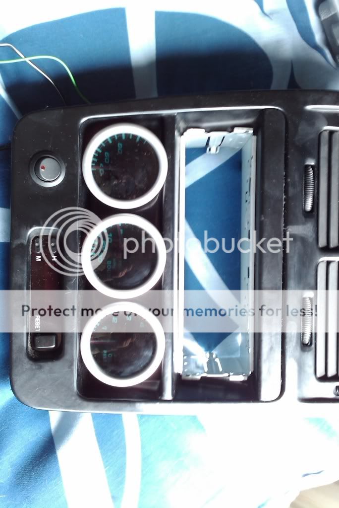

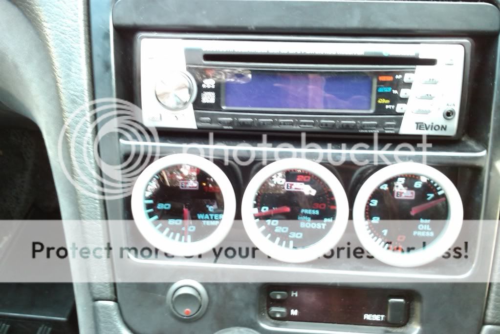

i made my own, but i've got the bezel if ya like, touchin the front of the surround, i had some black vinyl left so i wrapped the outside of the gauges with it, looks tasty...
IMAG0139.jpg?t=1285153152
IMAG0145.jpg?t=1285153152
IMAG0140.jpg?t=1285153152
Thats the idea i had tudor, maybe cutting a more elipsed hole to fit them in at an angle.
Did you make that piece yourself joely p? Looks like nice quality.
