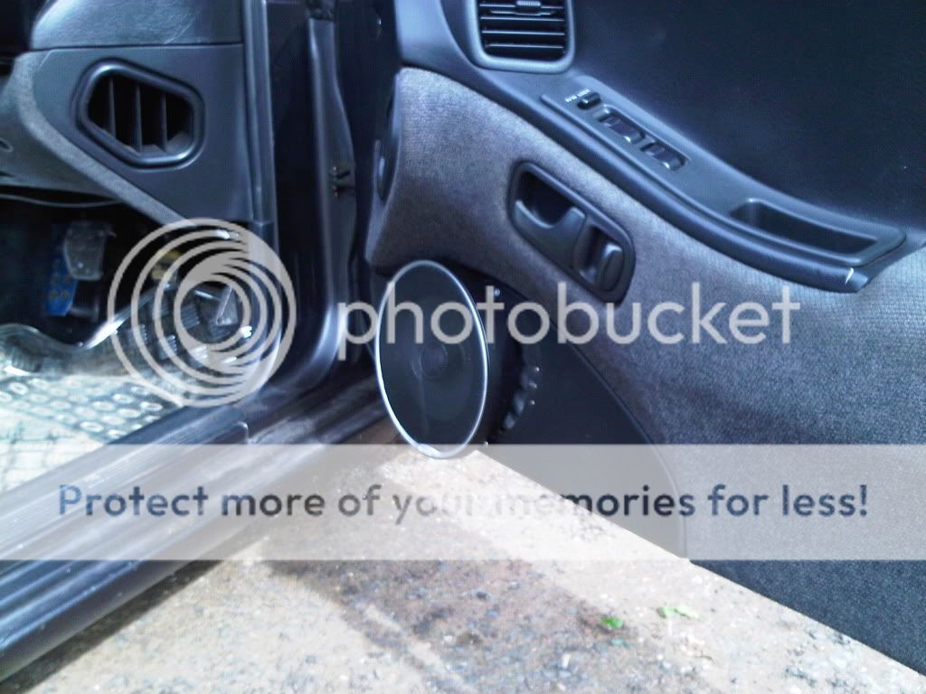

i've posted the pics of my door install on another thread, it will be on todays posts, its headed "front speekers"

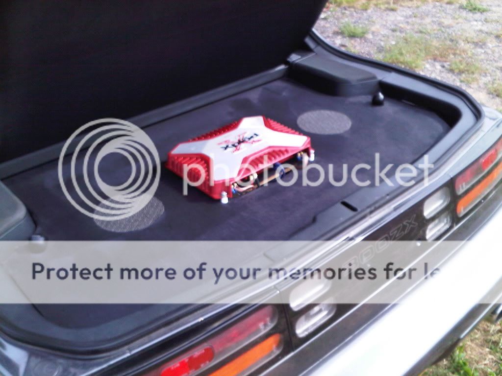

Hi Leo
The shelf lifts up to reveal ample boot space for a £120 trip to Tesco supermarket, i also have my wife up front and two kids in the back so no cheating there .The photo doesn't show this but the backs of the speakers are enclosed, this is why the amp is up top. There is no need for a sub as the enclosed boot and speakers give enough resonance to create the sub harmonics ( bass without noise ) needed.
The front of the parcel shelf sits just below the ( roller blind ) boot cover , and the back sits on brackets fitted to the side trim in the boot. The whole lot sit on a layer of memory foam and there is a hand grab for ease of lifting and removal if ness. In the beginning i did sit the back end on legs but they got in the way of the shopping ( my wife's favorite hobby ) The parcel shelf is cut from 1" MDF and upholstered in black faux suede. When the blind is pulled you can see nothing ....even from the sides. No screws hold the shelf in place as the memory foam creates a non slip/bounce cradle. i can send you some more pics if you want.
I'm using infinity speakers in the front and re-run some decent ( oxygen free ) speaker cables from the head unit to the doors. In the back there are also a pair of infinities backed with 10mm ply and ported. The size of these are important to get the correct sound. The head unit is Alpine, but any decent head unit that gives you control of the bass placement will work well.

Thats doublely awesome then!
Looks smart, good sound and practical to boot (make that triplely awesome)!
I wasn't even worried about my ice yet as I have other more pressing issues, but rest assured when I do get round to it I'll be following a similar tack. Good job Kr1s.
There you go Sky - problem sorted, all you need is a jigsaw, some MDF a bit of time and effort.
I had acoustic parcel shelves (very similar to Kr1s' effort) made by professional ICE centres (for an old pug and sierra) and did feel a bit ripped off afterwards. But the weighty MDF does give a solid platform for the speakers to work against. The last thing you want is for it to sound like a biscuit tin with a hand grenade in!

Kr1s, more photos of what you've done would be appreciated :)

Hi
You will see that i had to install some risers in the doors to accommodate the depth of the infinities. They are only about an inch tall and the grill just clears the rubber door seal.
There is no contact with the legs and the grills. There is some dyna-mat inside the door cavity but acoustic foam would be just as good. The speakers have tweeters built in that allow you to angle them in the direction that gives you the best clarity without hissing. I have since made two upholstered covers that are screwed over the remaining gap to cover up the ugly, i'll put the pics up tomorrow.
Oh! yeah , there are two super tweeters ( pioneer with in-line crossovers ) in the back and the two speakers are now covered by two 10" sub-grills.
This was my third attempt. There is a large hole below the amp to allow air to pass over and under it to keep it cool while the sun is blazing. and the cables just drop through.
I have also felt ripped off by so called specialist audio installers in the past now i know how to use a router and a jigsaw.
