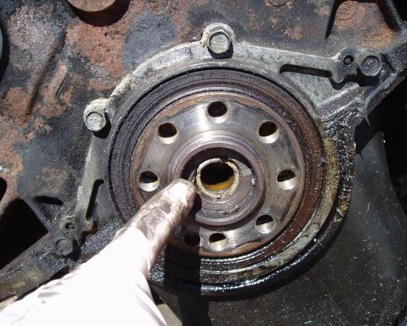

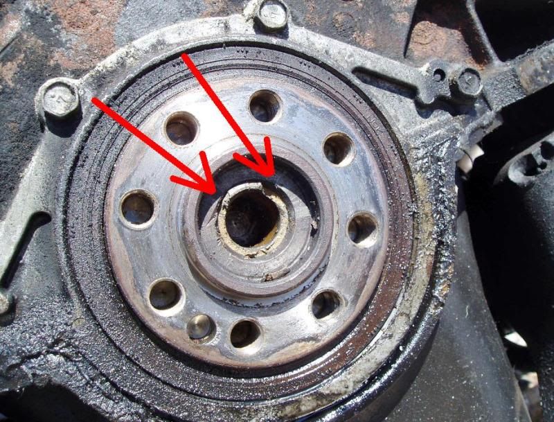

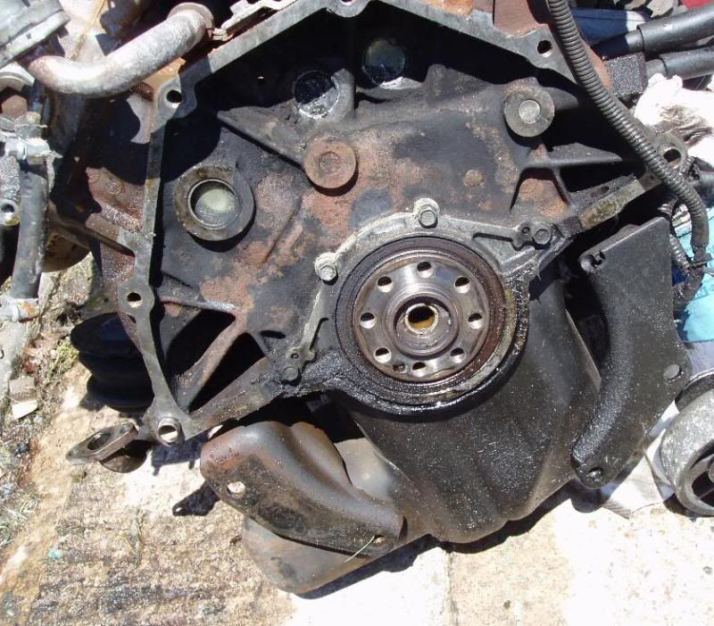

Oddly have seen a rise in badly fitted crankshaft spigot bushes on manual engines, if not completely flush with the crank face the gearbox input shaft batters the bush to the point it starts to break up, as you can see in the photo's the bush wear/ damage can lead to gearbox input shaft excessive movement which potentially can lead to noisy operation, vibration and at worse clutch or even gearbox damage, ignore the oily mess of the engine in the pics, was duff anyhow.
Mad this part which cost just a couple of pounds can cause so many issues if not fitted correctly, just a heads up for you.

That second to last pic is just what i needed to see the gearbox to block brackets. Cheers Jeff

Could it be the case that somebody has previously been trying to get the bush out with a chisel and gave up?
Oooo was this my dead engine by any chance?
Yup!
