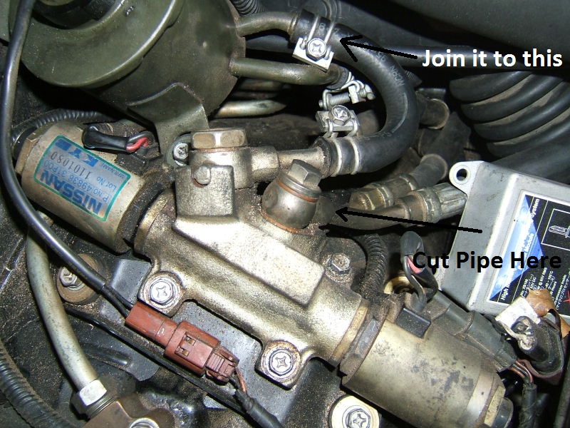

Update:
I've made the first bypass pipe. It's made out of high grade hex steel bar (used hex to allow a spanner/wrench to grip it for tightening) and only takes a minute or two to fit.It's also impossible to fit the wrong way round:thumbup1:.
Here's some pics of it fitted; The pipes lying behind it are the ones that go to the rack at the rear, these can now be removed all the way back to the HICAS.
To stop the new fitments from moving while driving, the pipe can be cable tied to the PS pump.
I'm now ready to start taking orders. Price will be £15 plus £2 p&p (£17 delivered). This will also include 4 new crush washers. PM me if you would like one. Please remember that they will be made to order, so will take a few days to arrive with you.
As the fluid bypass is made from steel, you will need to paint or protect it from rust.
