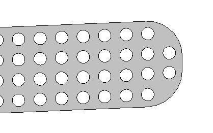

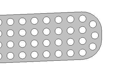

Been working on the LED conversion for the rear lights over the weekend and before I go any further with it I need some opinions on what would look best on the radius part of the light segments.
TYPE1
TYPE2
What do you think?

Which one? 70 members have voted
  1. 1. Which one?
    • TYPE1
      1
    • TYPE2
      69
let us know if your gonna actually go ahead and what the exact plans are i like this idea :D
Type 2. aswell. But there never on and no one ever really see's them so it dosnt really matter :lol:

Been working on the light units this morning. The indicator section has enough room behind the lens to fit the LED’s without any mods but that cannot be said for the side/brake section. Problem is.
1 The rear light unit has a screw which goes through the side/brake section and the recess is angled differently t the lens.
2 the inner radius of the side/brake section (closes to the centre panel) has no room behind the lens for the LED’s.
Only thing to do here is to use SMD LED’s at these places which means a slightly more complicated circuit board for the side/brake section.

i would love to say goodbye to the lenses completly and just have the leds mounted behind the perspex. can that be done?
Its better they are mounted behind the diffuser, you dont see the light source then and will look OEM
no split decisions here then! 2 for me!:thumbup:
dan.:thumbup1:
Type 1 or 2 will be an improvement on the clear corners ones, eg. take away the 2 lines of leds in the pic and you have the clear corner leds lol
