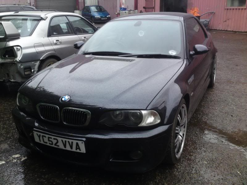

although its a damaged one, but its not much damage and im hoping to have it on the road in a month or so's time
only got a couple of pics, its fully loaded with loads of optional extra's from new

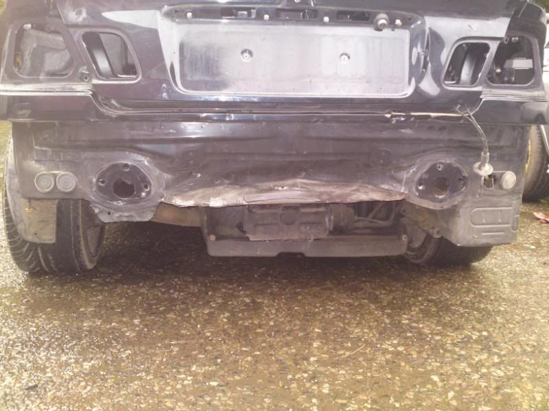

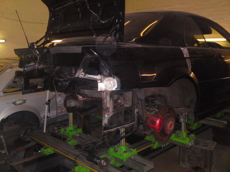

to pull the boot floor out and to straighten the rear qauters so only a small amount of filler has to go in
you drive it onto a platform where the car is strapped down solid, then there is hydraulic rams and chains and so on in place to basically pull all the car straight, they have all the measurments and the jig is set up to pull push bend all back into place
no mate, some are lasers, but mostly manual and mesurments, it also pulls out kinks and dings on the cars

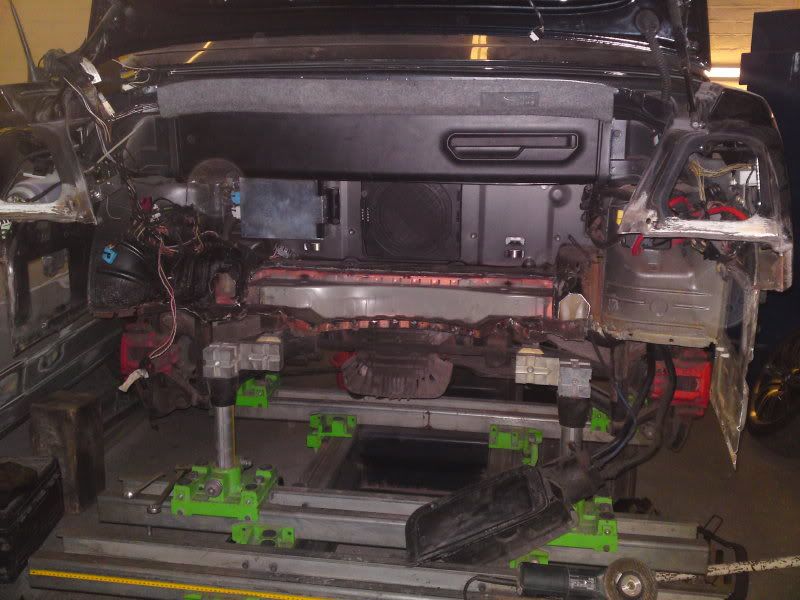

finally some work being done, took ages to get the jigger to do it, but worth it as he is the best in town
fook i thought you said he only needed to pull the floor out!!didnt think you meant literally ,thats a full cut out and repair!
it was at first, but then it was decided that instead of messing on beating and filling, it would be best to remove and fit new parts, all the joins have been drilled out and will be spot welded as factory, very neat and tidy job

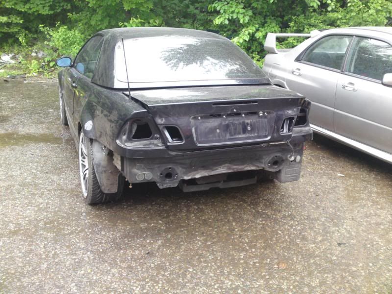

dave, yeah when the back end was bashed it dented and creased the qauters, so when it was being pulled he spot welded the rods on and pulled the dints
the work is great and it will need very little filler, infact i think it will just need spray filling to get perfect
