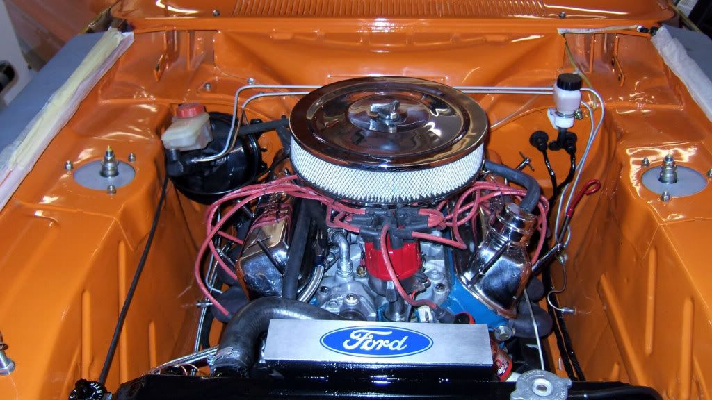

wow that is nice...302 by the looks but move that coil away from heat
Edited by znut
1 word wow. iv aways had a soft spot for fords how much bhp is that running
Bout 300
