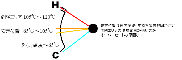

It wont. Its a non-linear gauge and wont move from that position till temp is over 100c. Utterly useless.

I've found the stock gauge will just sit at half way once up to temp, its not like a real time gauge, if it starts to head north then your over heating as i've found out in the past.

It's not that its unrealiable, just useless. A middle needle position indicates something like 60 to 110 degrees. By the time it starts moving up, you're pretty well stuffed
